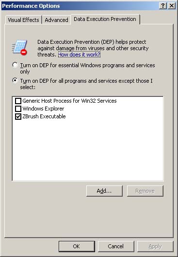

Others with 64-bit AMDs have tried this fix. Please see if it helps your case:
Could you check if you have Data Execution Prevention turned on for applications? If you do, could you turn it off (at least for ZBrush3.exe) and try ZBrush3 again?
To do this, you go to Start/My Computer and right click and select Properties. You go to the Advanced tab, choose the Performance section Settings button and then the Data Execution Prevention tab. Make sure “()Turn on DEP for all programs and services except those I select” is off. Or, turn it on and add ZBrush3.exe to the exception list.

I think it actually worked…! for me at least, and so far… i’m not sure if the crashing will happen again but this definitely helped.
and here is a screen shot of what i did:
