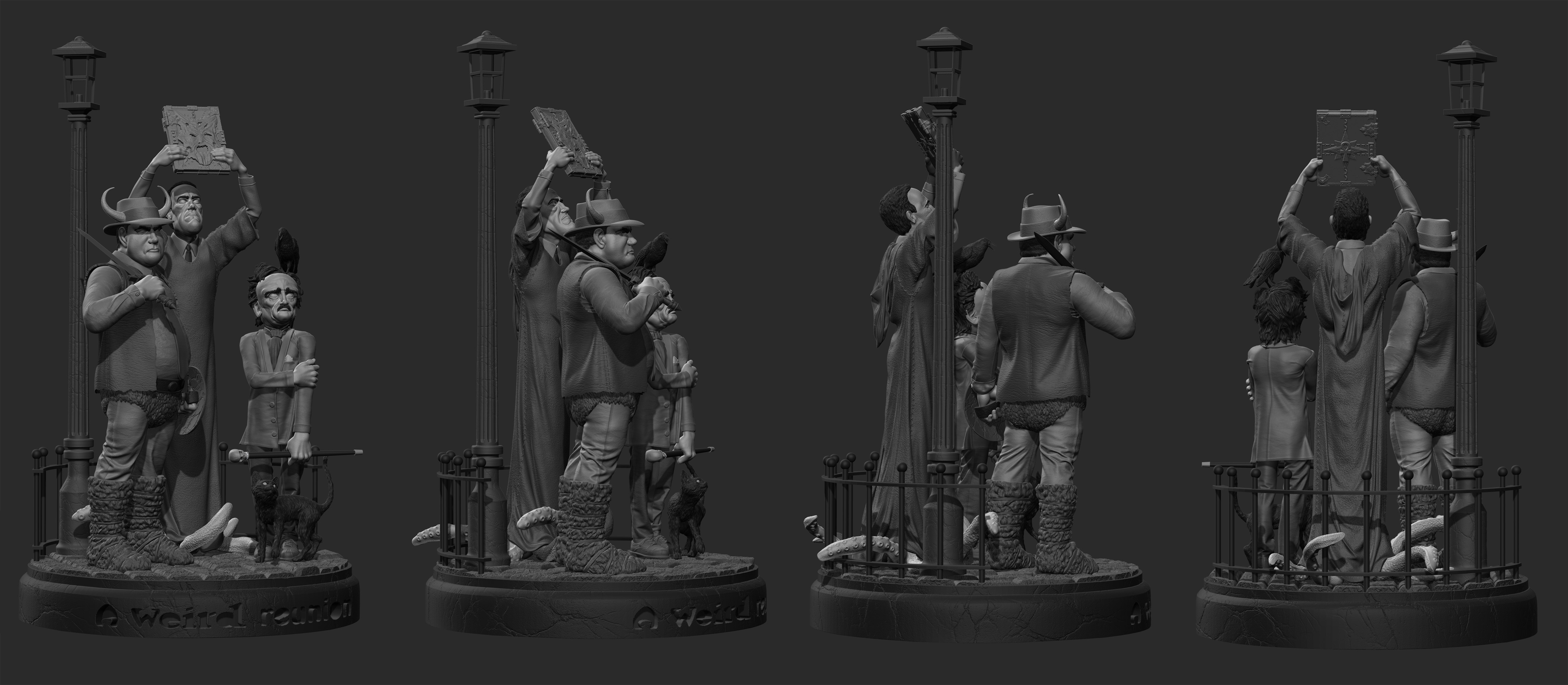

After the first meeting, I decided to try the new folders option, so I went for a three figures design. I worked it as it was meant for a collectible, there is where I come from, don’t ask me to go besides my confort zone. And picked an idea I had for a long time but never made the space to do it; a tribute to 3 of my favourites writers: Poe, Lovecraft and Howard.
I created four folders, one for each figure and one for the base elements.
I also wanted to try the new and imporved zremesher, so I used three heads I did with zbrush 3.1 a looong time ago. The new zremsher was pretty appealing as I work with Marvelous Designer to do the clothing, and when the objs are imported to zbrush I need to have the meshes with thickness. So after working with the imported objs, cleaning some ****s and acomoddating them to the figures, I do a negative extraction to have that mentioned thickness. I do a dynamesh and work on it to almost achieve the final look. The new zremesher allowed me to keep that edge loop created when negative extracting and once I have the low poly remeshed tool I subdivide it to a proper polygon account to then do a projection and add all the finer details and textures. To have that edge loop is great to keep a sharp and clean edge.
The Lettering was done with an alpha and shadowbox. Aligned to the surface with matchmaker and then with bollean substract. The base was done with primitives. I used some elements from previous models I had and dynameshed and zremeshed them.
Well, hope you like it. And thanks again for this great chance
Here is the final piece rendered in keyshot and some photoshop on it
The piece rendered with zbrush
The turnaround also rendered with zbrush
