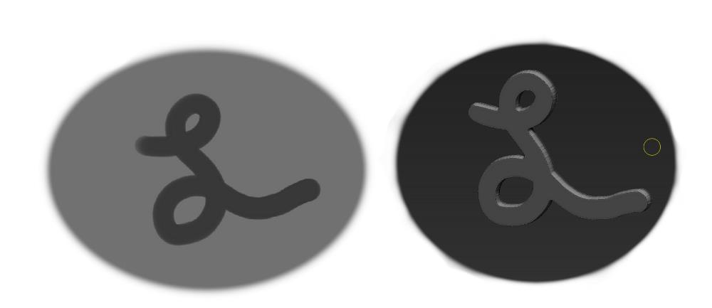

What I mean by intuitive would be being able use the simple brush to freehand brush a letter that would generate the usual series of close-packed ovals that comprise any brush path, as in Photoshop or Motion , and have ZBrush generate an editable 3D mesh generated out of each in-between oval profile along that brushpath. What I’m learning is that that’s not how ZBrush operates.
Anyway, what has emerged for me in all of these suggestions is discovering how far I can push the proper use of the masking brush tool as my calligraphy brush on an already created 3D mesh plane and then using the resulting mask of the brush path to define an editable 3D mesh letter based upon that resulting freehand-brushed mask. The issue becomes the amount of edge detail ( as in sans-jaggies ) one can achieve to preserve the accuracy of the freehand calligraphy brush path made 3D by being able to convert that mask brush path into a 3D mesh. Sorry if my explanations appear a bit wordy ( I notice that my ability to upload image’s of graphic examples of the level of calligraphy I am talking about does not have its permission code turned on and I’ve no instructions how to get that forum feature turned on so I can’t ) , but this is how I best describe it and the responses have been very helpful indeed.
Quick screen shot, I know it’s not exactly calligraphy but you can use anything really. I just grabbed an alphabet off the internet and made this Z 3D with masking in less than 2 minutes. Unless you’re doing something absolutely insane you should be able to take any calligraphy you do and make it into a 3d tool. And even then the most insane is achievable if you learn your tool set. Hope it helps. By the way I used light box to paint it on to a plane and masked by intensity and poly grouped that mask then hid the rest of the plane and then deleted hidden then used panel loops. Like I said less than two minutes. Good luck in your explorations.
[QUOTE=mrmedellin; I know it’s not exactly calligraphy but you can use anything really. I just grabbed an alphabet off the internet and made this Z 3D with masking …you should be able to take any calligraphy you do and make it into a 3d tool. …Hope it helps. By the way I used light box to paint it on to a plane and masked by intensity and poly grouped that mask then hid the rest of the plane and then deleted hidden then used panel loops. Like I said less than two minutes. Good luck in your explorations.
I do appreciate your feedback ,Mr.Medellin, and only just this morning fell upon a ZBrush tutorial on YouTube that reinforces your solution. It’s entitled Creating lace Panel for Insert Mesh Brush ***9654; ZBrush - Creating Lace Panel for Insert Mesh Brush - YouTube which demonstrated to me that one could use a brushpath image with delicately detailed lace patterns and translate them into rather detailed & ,more important , fully editable 3D meshes. Only problem was ,and it’s unignorable , that the tutorial author offers no commentary whatsoever in describing her process choices and the resolution loses substantial clarity when full-screen so one can not read the bloody UI text thus you have to already know the UI like the back of your hand to fully understand her precise procedure . This is why I love this forum because under what words in the index would one query in order to read about this procedure in the manual’s index or the Get Started Guide? Trust me I looked. I’ve found that being pointed toward well-executed tutorials are the way ( BTW: Thank you Mr. Pavlovich). That said this eye-opening process was given further reinforcement by the Make Jewelry Ring Using Alpha ZBrush which informs me that I can just craft whatever detailed calligraphy I chose using Photoshop’s fully adjustable calligraphy brush to create an alpha of my freehand illustrated lettering and import it within ZBrush and convert that into a fully editable 3D mesh. This solution works for me as far as allowing me my thoroughly familiar intuitive flow of brush execution. I can use Photoshop’s fully adjustable calligraphy paint brush , like I’ve always done ( I guess my mistaken approach was in thinking that I could do that within ZBrush , and just export it into ZBrush as an alpha brush print and project it upon a 3D mesh plane and adjust its desired thicknesses & materials accordingly. Sounds like the most intuitively natural solution to me. Am gonna experiment with this approach from this moment forward thru nightfall.
I checked out that video and it looks like she did what I had described with polypaint and masking with maybe a little more time in adjusting the options for masking and spotlight along with the panel loops features.
She states a simple explanation for what she did: “A little Nosferatu design in a lace panel created for an Insert Mesh Brush. Spotlight texture applied to plane, then masked by intensity. Panel Loops created with unwanted areas then deleted out. Alpha used to create bumpy texture. Inflate brush used to simulate knots on larger areas. Color and Cavity Mask painting applied for texture. Zremesher (not shown) was then used to cut the size in half before making the Insert Mesh brush in a more practical form.”
Which happens to be exactly what I did for the Z I showed you minus the inflate brush and textures. And then the whole business about insert mesh creation is just so she can insert it later into a piece or whatever she wants it for. But yeah do all the videos I told you about and the spotlight videos in the class room and even the IMM brush tutorials and you’ll be well on your way to getting what you want. Good luck.

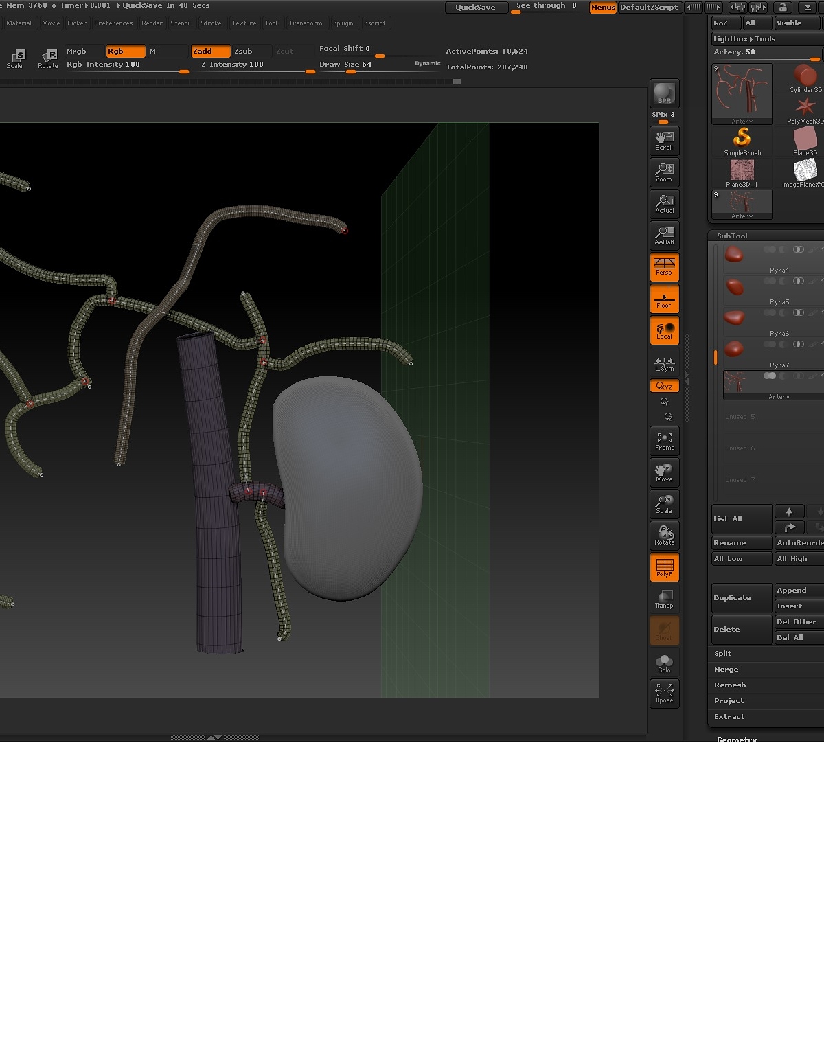

Why are my simple branches off of the initial curve I’ve drawn, going off super long in another axis?
Thanks for any help!
