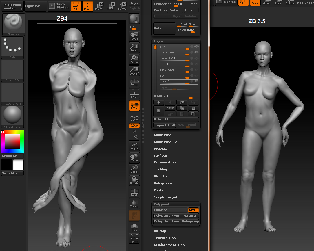

Zbrush 4 loaded with one of my recent W.I.P just didnt take to kindly to my pose.
Same file, different result.

I was just about to post a long discussion on how the 3.5 layers aren’t coming in well, I guess I missed that in the documentation.
On one of my models a pose layer does nothing when it is turned off and on, (so it’s stuck in that pose ) one has terrible distortion, one has a layer imported as super strength (need to set it to -1 to get it back to the 3.5 ‘off’ state, and strength 1 is equivalent to about 1.5 in zb 3.5.)
Worse, going up to the highest subdivision and clicking to enable a hidden layer causes ZB to crash. (Note the layers are one level below the max subdivision)
Also, highlighted by the crash mentioned, there’s no way to tell what the subdivision a layer is currently set for, which makes it dangerous if you forget :slight_smile:
These problems don’t seem to occur with layers created in ZB4.

That worked doing it that way, thankyou. I had already tryed everything els like importing a lower sub d of the pose which did update it fine, but after turning it off, then back on, the mesh folded up, same even if morph target was stored.
