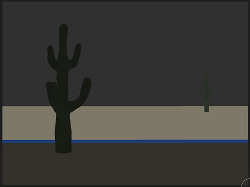

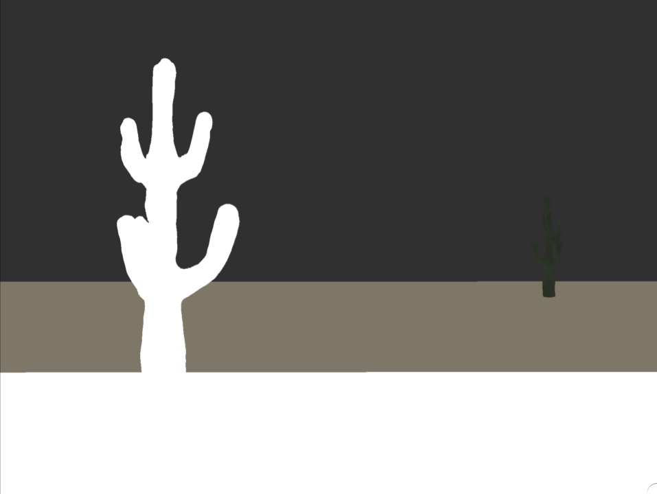

There is an exercise to show renderging capabilities of ZBrush, but my zb rendering do not behave as expectd.
I have a document that show up well in preview mode, but when I change to Best mode, it does show up weird flat stuff , and not shadows ( as the attached files )
I’m using zb 3.12b on Mac Os X 10.5.7
Any ideas? thank you guys

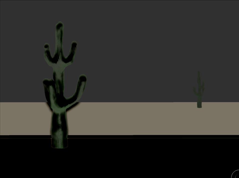

I did the update to the 3.2, and the rendering is chaghed a bit.
I’m really a newb … I don’t know how to know what materials are in the pixols…
This document (that was in the book dvd) should be just a demonstration on the differences between the preview and the best render mode, especially for the shadows, that should be “flat” in the preview mode and “oh the ground” in the best mode. But when I hit the render button it makes this :
I hope this can help you to help me :slight_smile:

As for the rendering problem, I can’t know much without being able to check out the document myself. But it’s a safe bet that the book was not written for 3.12 or above. There have been optimizations and changes to the rendering engine, which will affect older documents.
