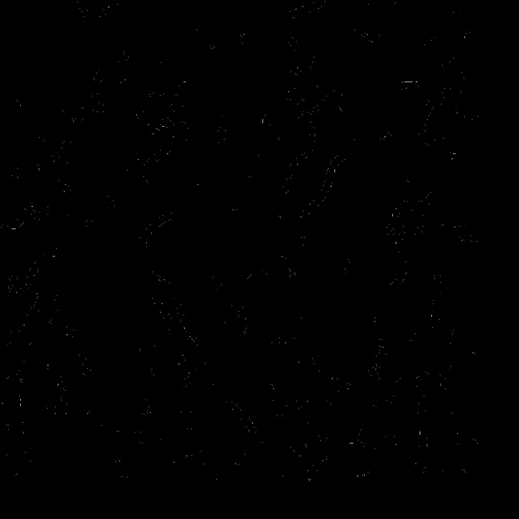

I can’t create usable alpha from mask which I have create using mask by cavity.
Alpha mask is attached. It just has a lot of speckles around where a mask should be.

Having the exact same issue here (Exported maps look very similar to yours as well).

There’s also another way to do it. If you have any polypainting on your model, erase it by filling with white. Then, you could generate the AO/cav mask as usual, invert it, fill the (now masked) object with black color, and just use new from polypainting. I’ve tried that and it worked perfectly well. :slight_smile:

@Boris Goreta - In the upper left corner of ZB interface, there’s the Color dropdown; open it, and press FillObject. It will fill the entire model (with respect to masking) with the currently selected color.

i get the feeling it has something to do with the create alpha from mask feature not reading the UVs. anyhow i found the same work around as already mentioned. just mask the model as desired, then fill the unmasked parts with a color, then make a new texture by clicking on “new from polypaint”, click clone texture, then from the texture menu up top select “make alpha”. after the alpha is created you can invert if needed.
