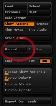

can you record zscript session???
i try and from the release i cant record anything! Will you please show me how you record a session?
Thanks in advance
Andre,
Well, you can record, but as far as I can tell it will get all garbled. To record, I open up my zscript menu from the top and just hit the “rec” button. It’ll ask to initialize, I let it. Then I load up my model and sculpt. When I’m done, hit “end rec” and name the recorded session. To play it back, I flip open the script panel at the bottom of the interface by clicking the arrows to toggle it up. Then I press “play.” All that said, the recording is all messed up at the moment, but that’s how it’s done to my understanding.
Thanks! yes, that was the usual steps to record but i suspect that is not working…i cant reproduce anything from recorded session. thanks anyway:+1:
