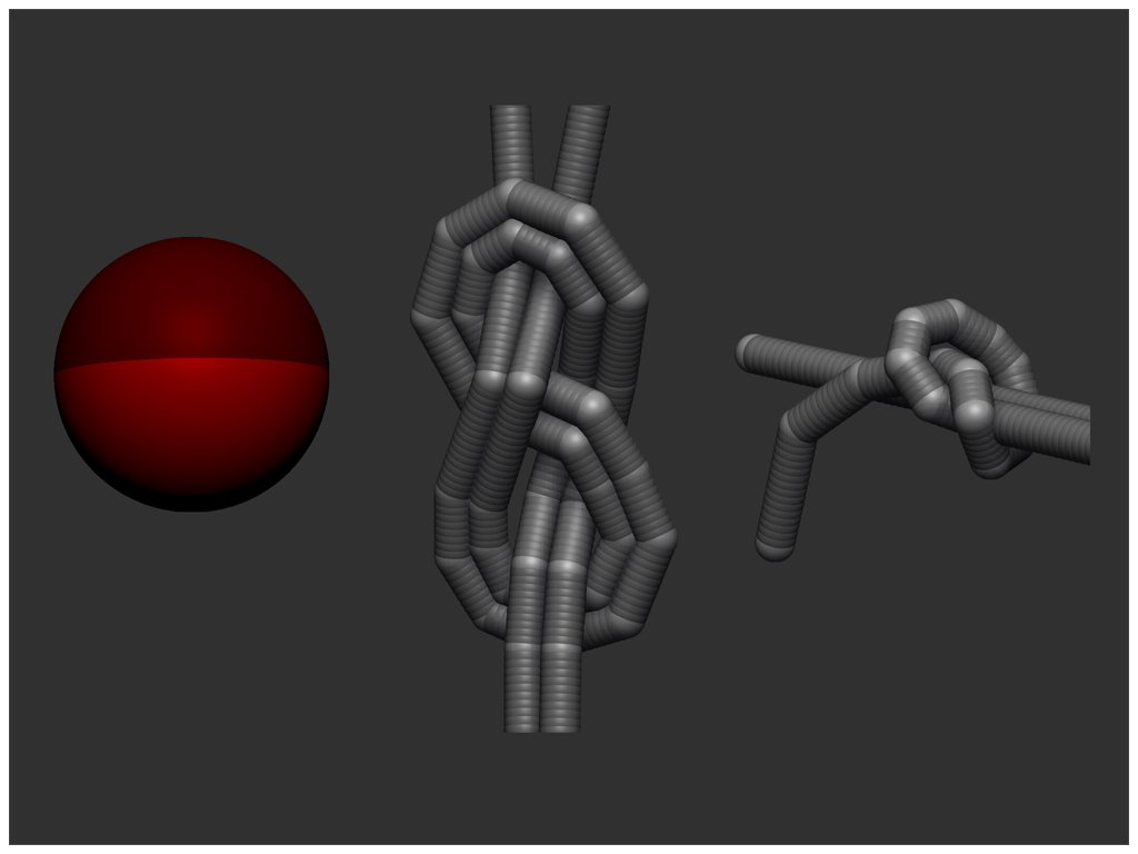

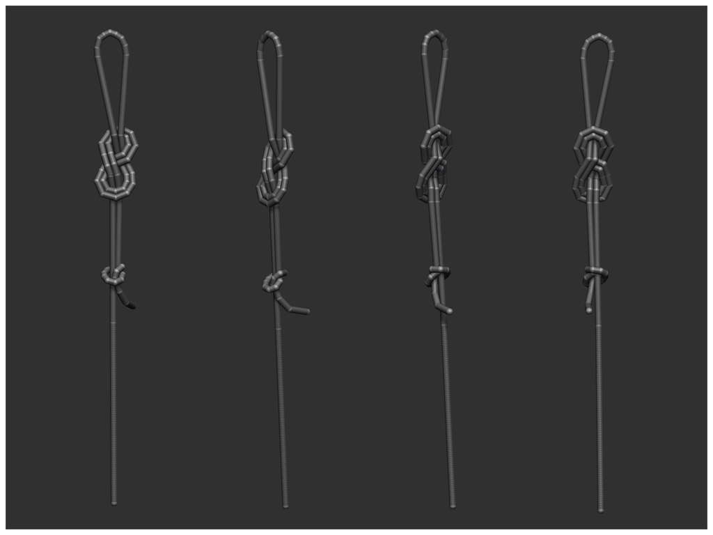

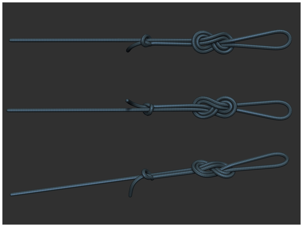

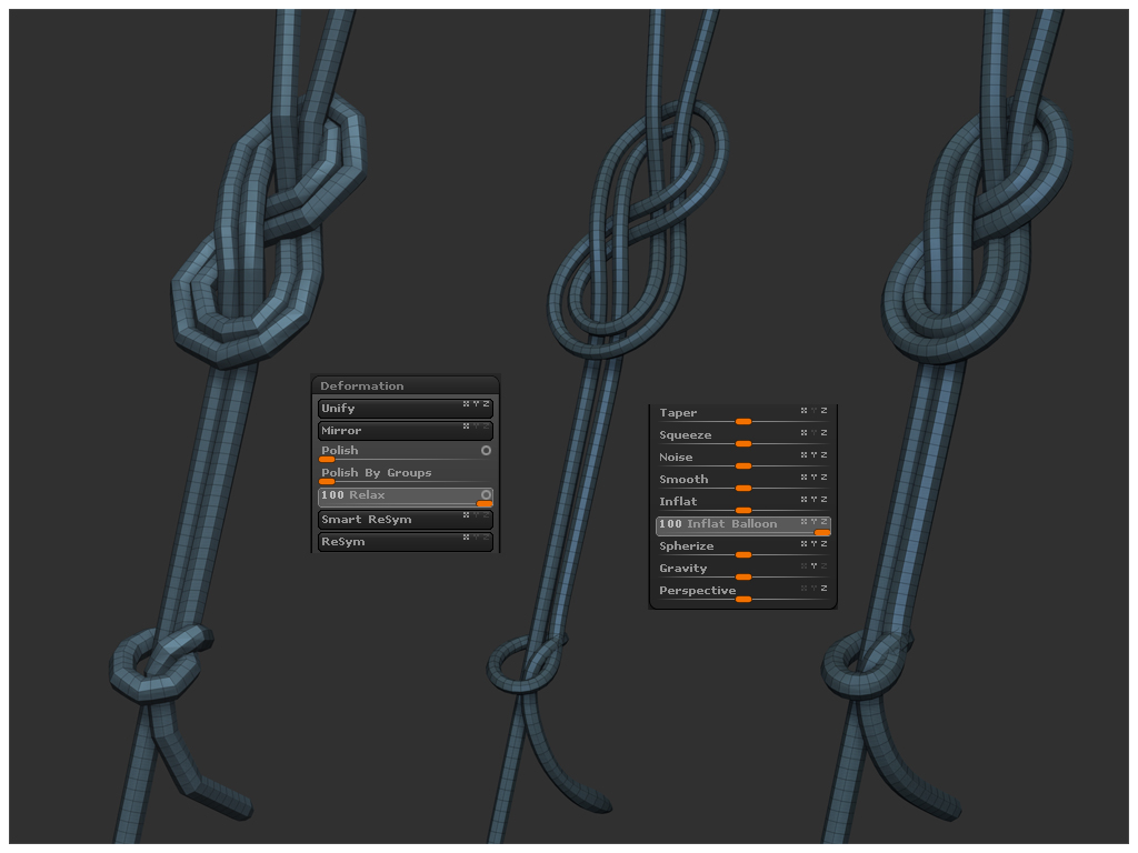

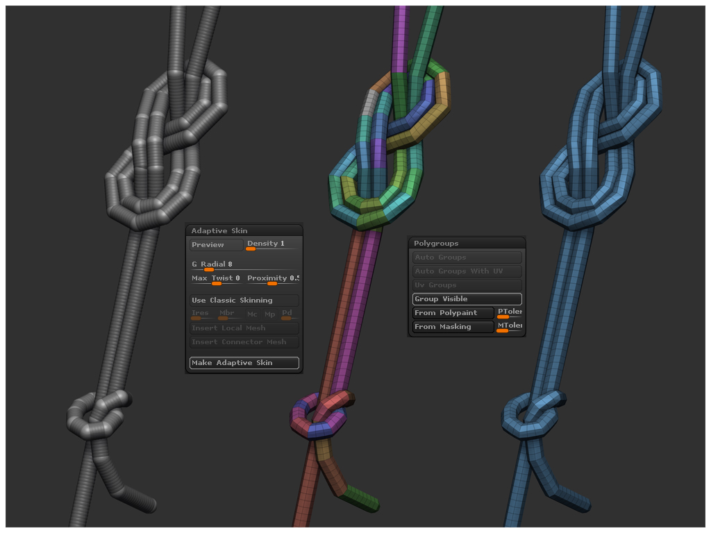

Some big changes in my life recently have minimized my time devoted to sculpting outside of work, however, I would still love to share as much of my Z4 beta experience as I can. I will continue to grow this thread as my work progresses. A huge thanks, as always, to everyone behind the making of Zbrush. It is because of you that I am able to do what I love every day. --- Modeling complicated knots has always been a hassle for me in the past. A few simple, yet amazing new features in Z4 have now changed that forever. Here is a quick step-by-step for modeling a Figure Eight Knot in Z4 using ZSpheres, Adaptive Skin, Relax and Inflate Balloon. I find this method so much faster than hassling with splines in other applications and a lot more fun! The end result is clean, production friendly geo ready to pose or export and sim. ![Z4_knot_001.jpg|1024x768](upload://ruDFuBMWnpNuYBrzor3G7p47K2W.jpeg)

arsalanali - Yup, so much better than other methods, at least that I’ve tried. Thanks!

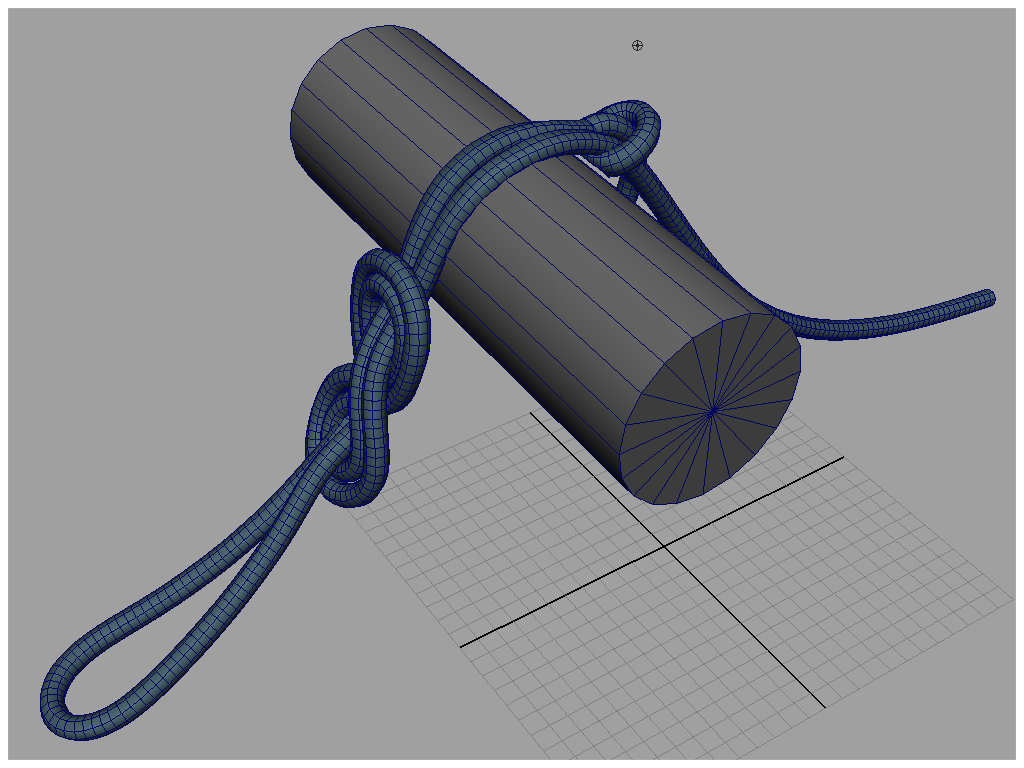

TyShelton could you please clarify - which method was used for bending this curve in maya?
I like to know how to texture the rope, any tutorial on this?
eof3D - I exported the knot straight out of Z4 and simulated it using nCloth in Maya. The cylinder is thrown in there to act as a passive collider.

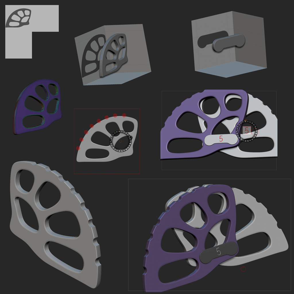

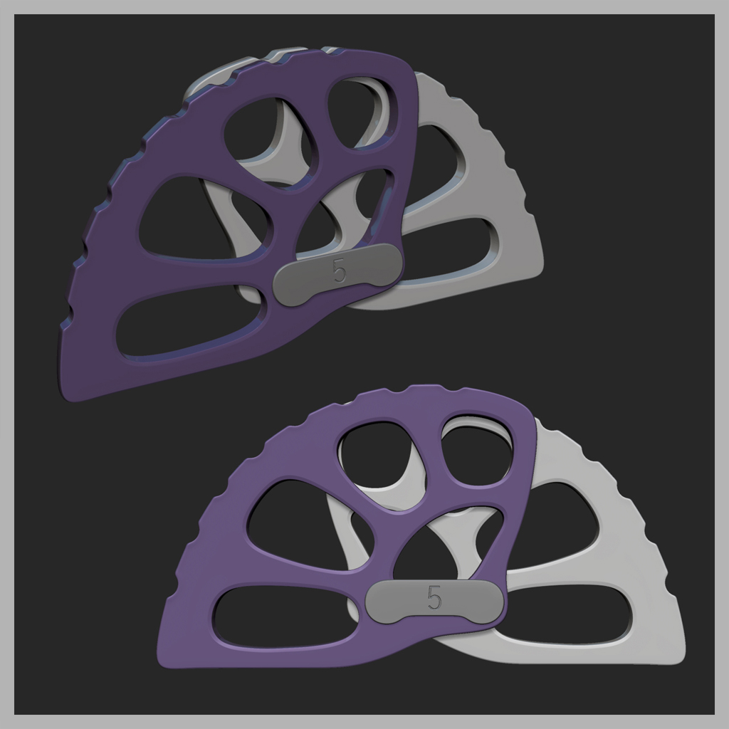

Just a question, with your Quick cam sketch, how did you manage to use the clipping brush at equal distance on an unusual curve like that?
If I remember correctly, I believe I just set up a little PS cheat. Basically, took a snapshot of the cam before using the Clip brush, brought that into Photoshop and placed circles where I wanted the grooves to be. Then I took that image back into Zbrush using Lightbox, lined up my model on top of it and essentially “traced” the circles with the Clip brush. Cheap but it works. :smiley:
