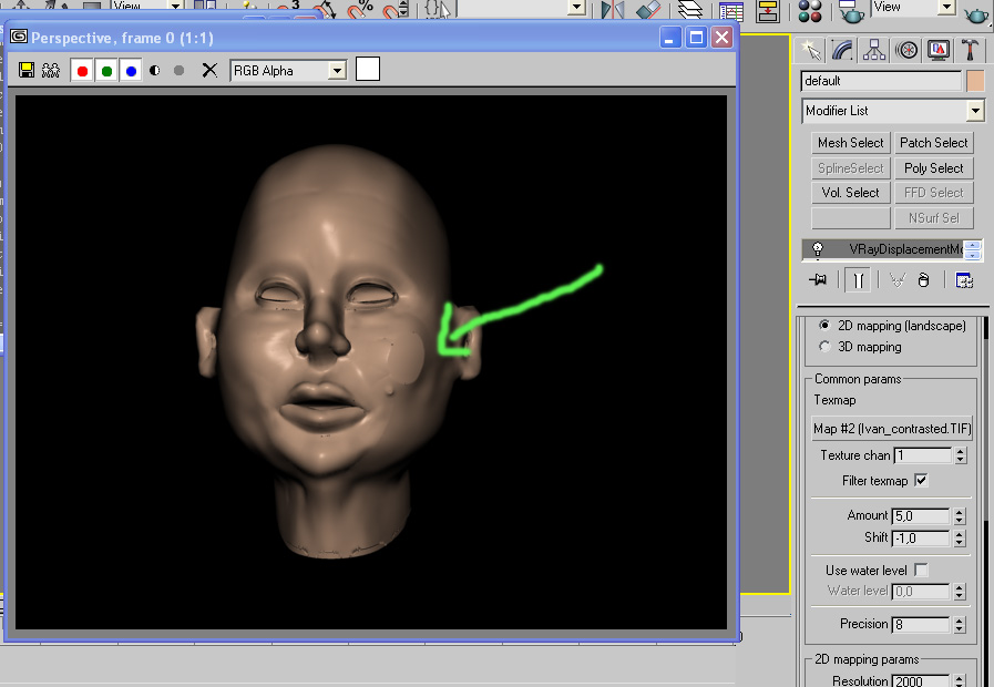

could be a great help.
I had a lot of headache and had this result with Max displace native modifier.
I followed the instructions to use VRay displacement Mod but , no matter
seting all the sugested amount Shift values.THE RESULT IS A MESSED UP
MESH OR A BLACK SCREEN.
I tested with other files and Vray worked fine for displacement.I am probably doing something wrong.Can someone help or share a successful Vray
displacement Max 6 file with me?

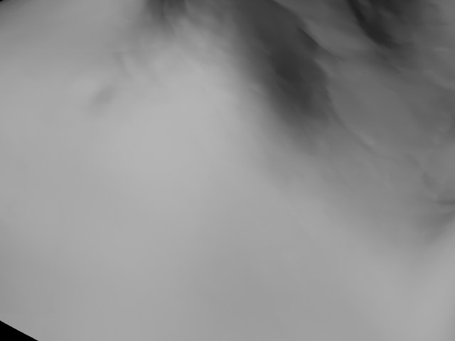

When I finnally got what should really be easier to get, There is a curious
artifact , that the original Zbrush model does not show.See picture above.
Please Pixolator , have pity and help I am strugling for weeks now!
Yes I researched a lot and tried everything before writing.
How can I edit this thing out of my displacement map?
Luiz Mihich
It looks like the high displacement values have been clipped. You may be able to prevent this clipping by readjusting your import or displacement modifiers in Max. If you’ve taken the map through a 2D image editing application, that software may also have readjusted the displacement values which in turn resulted in this clipping.
I never have these level value…
5 and -1…
In my setup allways, the negative value is the half of positive value.

As a matter of fact , I imported 2 versions of displacement maps .
One of them was exactly what ZBrush created and exported as alpha
displacement , but the other was a heavily contrasted one that I retouched
on a very obsolete Photoshop 4.0 light version ,( I altered the levels of the
image), but this is the map you see above and the displacement , at least
happenned, I had similar result with Max displace modifier.
I am aware tht I shall use always half negative shift values,so I was
surprised to see -1 worked much better than -2,5 for instance, but the
mesh shrinked rather than deformed with the last value apllied.
I also played with output values inside material editor .Something is really
wrong,and if it is not asking too much could you give me step by step
advices from exporting displacement maps to Max until render the instance map already inside Max 6.0 interface ?:o :+1:

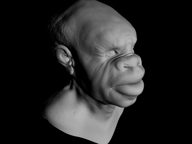

To show you the result with some renders :
before
voila!
I hope it helps some of you!
Alex

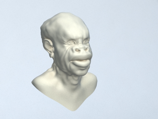

hi guys!
So. i’m in trouble with displacement map.
I started my model with zsphere. After I tranformed that to polymesh, I exported that to 3d Max . Then, after some tweaks, I exported the final model to Zbrush to start high detailing. The first picture, shows the final model in zbrush.
I down to subdiv 1, and exported the lowpoly and bring that to Max. Everything ok until here.
I exported the texture and flip the “V” with -1 value in max, and, everithing ok. The texture fit fine!
So on, i created the displacement map, exported that as tif, psd or even bmp, but, when I put the vrayDisplacementmod, I have a lot of problems. You can see that in the picture below.
I tried to apply the AUV, GUV, and others to export the displace map, but nothing seems to work.I already read a lot of methods to do that, but I dont know what else could i do…
I’m getting frustrated about that. Can anyone please, give me some idea?
