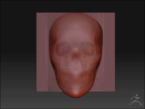

I’ve been trying to figure out how to work with image planes, by following the tutorial on pixologics site (this one). The problem is I cannot assign the Flat Color material to my image plane at all, after I choose fill object and switch material it changes. But if I do this on the head model it works! Does zbrush hate planes?
Secondly I can’t find a way to reduce the transparancy of my head model in order to see the image plane underneath it. It’s done in the tutorial but with no explanation as of how.

"If you do not want the image plane to share the same material as your model please follow the steps below:
  1. In Tool: SubTool palette, select the X-plane subtool
  2. Select the desired material. See below if you wish to use the Flat Color Material.
  3. Select M in the Draw Palette.
  4. Press Fill Object in the Color Palette.
Note: you can assign the Flat Color material to a surface however, you have to do the following steps:
  • select the Flat Color material.
  • Press the Save button in the Material Palette and save it to disk
  • Select a Material that is not likely to be used like a Fast Shader.
  • Press the Load button in the Material Palette, and load in the Flat Color material.
This newly loaded Flat Color material will allow you to assign it to an object. When you are done, make sure to select your main mesh, and change back to your modeling material, such as Red Wax.
You might ask why? The Flat Color material resides in the 00 index of the Material palette. This allows it to be used to unassign a material to an object. Effectively, by assigning a material of 00 to an object it assigns no material to the object"
