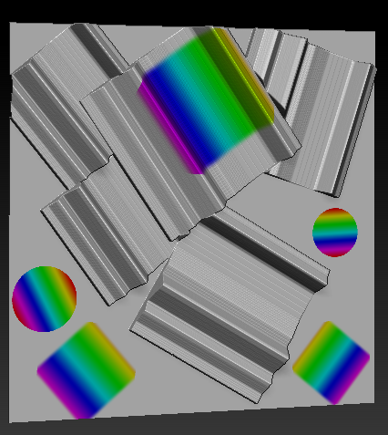

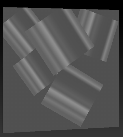

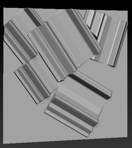

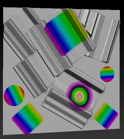

I think you can do it already with textures and dragrec etc simply using gradient texture. The same with subtraction of masks.
Yes you can use alpha27 and drag out a gradient filled mask rect somewhere. But I think a “real” photoshop like gradient brush could be a lot more useful.
The real difference with photoshop is the gradient editor that Photoshop has and Zbrush doesn’t. But obviously you can create a bunch of premade gradients. Also Zbrush has curves for intensity in radial gradients that can be edited.
