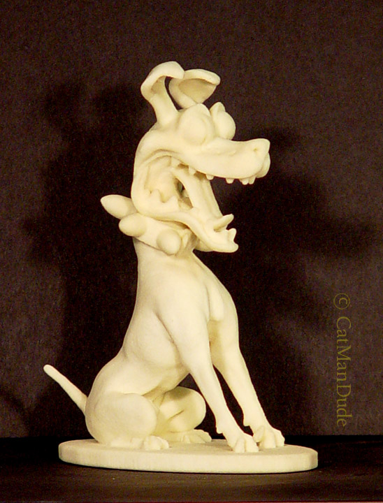

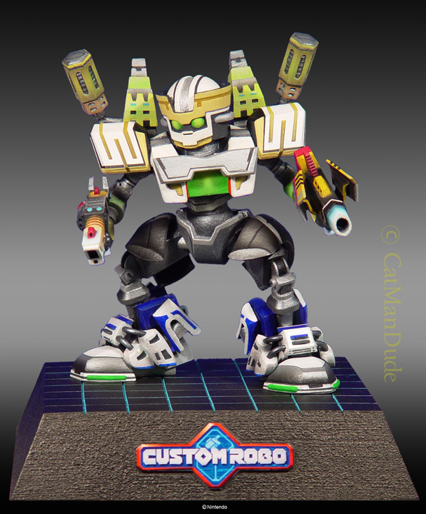

While we are waiting for Wild Thing, here are some photographs of actual 3D printouts from designs created in ZBrush. The Robot was modeled in Rhino and ZBrush. The Dog and Leopard are just the raw builds before finishing.
CatManDude
…[attach=14351]CR_Final_03.07.jpg[/attach]
…[attach=14352]Dog.jpg[/attach]

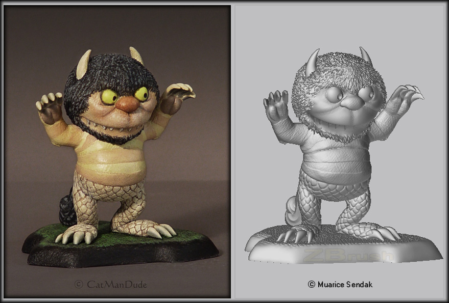

Hi Everyone,
Sorry for taking so long in getting back to you with the final photograph of the 3D printer output, I decided to paint the model and it took a bit longer than it should have…you know… work…family!
Anyhow, my daughter loves it even though she is sweat sixteen and full of other distractions!
The process:
Love the book
Direct model in ZBrush using ZSpheres
Detailing using PM
Magic by ZBrush
Output size 4.5".
Fine detail , like the hair, is always an issue…you can loose it on small models.
That’s it. Hope you like it.
Thanks,
CatManDude.

is that the Zcorp printer or the Envision? You got some beautiful feedback. I liked how you modeled the feet right into the platform.
Hello all,
Thank you for all the positive feedback.
Unfortunately, I did’nt happen to take a shot of the raw build.
The printer I used for this was a Z-corp. It is very versatile,but for tiny printouts, the surface is a bit rough and a fair amount of post processing is involved prior to painting.
The material cost is under $20., but a few days are needed for the finishing process.
CatManDude
I took model construction all throughout my 1st through 3rd terms at ArtCenter(being 6th term now). I can honestly say its alot of post process work goes into something that comes off Z-Corp mainly because a starch print requires that you seal it, prime it (with the good stuff ,poly primer) and then fix your surfaces. Its dirt cheap and hellla fast to go with it.
Tell me how fragile were those teeth and smaller details? Did you do all the final solidying and sealing or did they?
What I would recommend in the future for finner results is to use a finer tolerence settings in the Zcorp software ( I have notes on how to do this if you want me to post it). This would have caused the machine to take long to print but might have achieved finer results.
