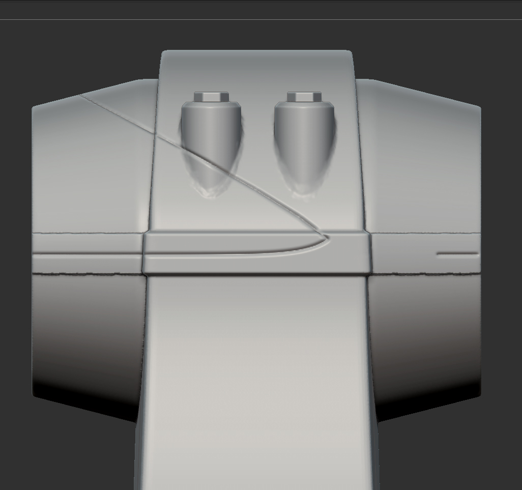

have been getting this issue for the last 3-4 of versions where sometimes when i draw a line with lazymouse on it seems to draw a line from the top left corner of the screen to the mouse cursor it somehow even breaks the line when holding shift to draw a straight line.
this image show me trying to draw a line holding shift(happens without also) from left to right.

Yes, this issue has been around for quite some time now. It will do it with LayMouse turned off also. If you are adding detail with a pen and using qiuck strokes, every so often a stroke will shoot off to the upper left and you have to undo. Sometimes, you don’t notice it and, after working more, you see it later after you rotate the mesh. It can get very annoying after a while. This has been around so long that surely Pixologic has to be aware of it. Why it hasn’t been fixed is anybody’s guess. Maybe it just isn’t on their list of prioreties.
