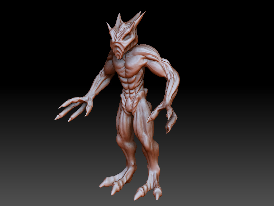

I sculpted an alien head, from a polysphere3D.
Subdivided 7 times, can t do more.
I made the body out of ZSpheres and I sculpted it.
Subdivided 8 times.

So, my question is, can I merge those two objects or do I have to start one of them over to match the other’s subdivision level ?
I give a visual representation of the two objects, dunno if it’s useful or not.
hi EaZoToP your images didnt show up ? its always better to model the head attached to the body but you can append the two and merge visible in the subtools menu then export it as .obj then reimport it using the import menu - adjust the weld settings and merge try different settings and reimport,trying to get polys to line up on two different meshes will not be perfect tho.

So, since I’m sometimes a bit dumb and because I can’t manage to upload my image, here’s a link to my DevientArt post
http://eazotop.deviantart.com/#/d3bm6a7
