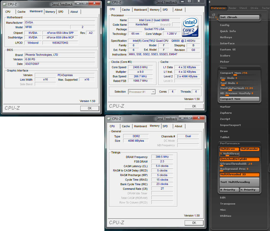

Zbrush is crashing alot. I didn’t know about the CTRL+S thing, so I won’t use that anymore. I get crashes alot when unhiding/hiding polgroups, even at low-poly levels. I get random crashes quite a bit as well.
Here is my system specs:
[systemspecs.jpg](javascript:zb_insimg(‘130612’,‘systemspecs.jpg’,1,0))

up your compact memory, you have it set to 256. so you’re telling zbrush you have 256mb of ram. I’m guessing you’d rather have the 4gb. Anyway, since you have 4gb, you should be safe around 3200 or so, going higher than that you can’t have anything else open, and your OS needs some of that as well.
And I never use poseable sym, so I don’t know about that I always sculpt, pose, refine sculpt to match pose. Just my work flow, so eh, I don’t know.
The crashes are probably coming from your mem settings though. Zbrush was probably writing to the HD more often than not. I rarely crash, unless I am hitting the up or down arrows way too fast.
