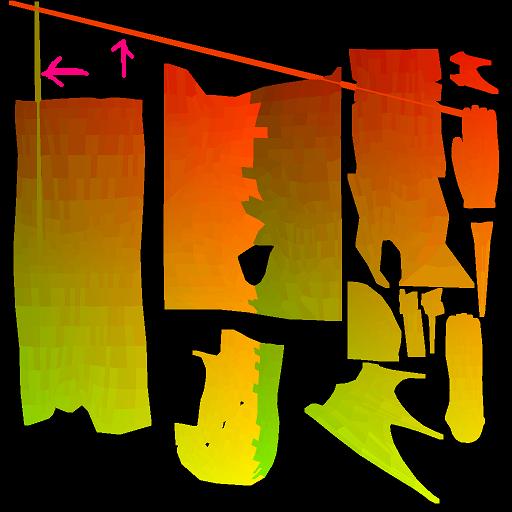

why are these lines on my uv map?
Does anyone know the reason why these lines appear in zbrush on my edited uv map? Edited in maya before I imported the mesh in zbrush, after 2 weeks of detailing and sculpting, I can no longer edit a part on left hip and the entire lower left leg Onry, the rest is fine with no problems. I’ve been in a stalemate in progress since this happened on thursday, any hints to help me solve this is greatly appreciated , TY.

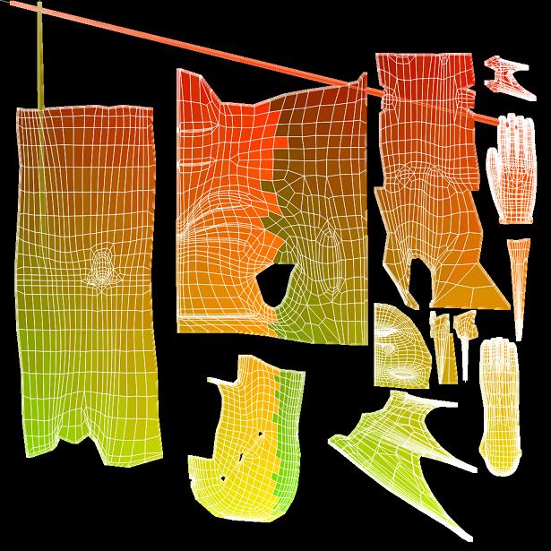

heres a wireframe version,

and i fixed the unable to edit problem, but my map still has that line and im not comfortable with that. any clues are greatly appreciated!
You have stray UV points that are causing overlapping of UV’s; meaning you need to go into Maya’s UV editor, grab the UV points that are out of whack and reposition them into their proper place. Sometimes when you double up on the UVs (like putting two legs on top of each other, or two arms) it makes it tough to see just where the UV belongs. But once you get it back in place you should be fine. Hope that helps out!
