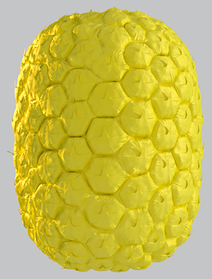

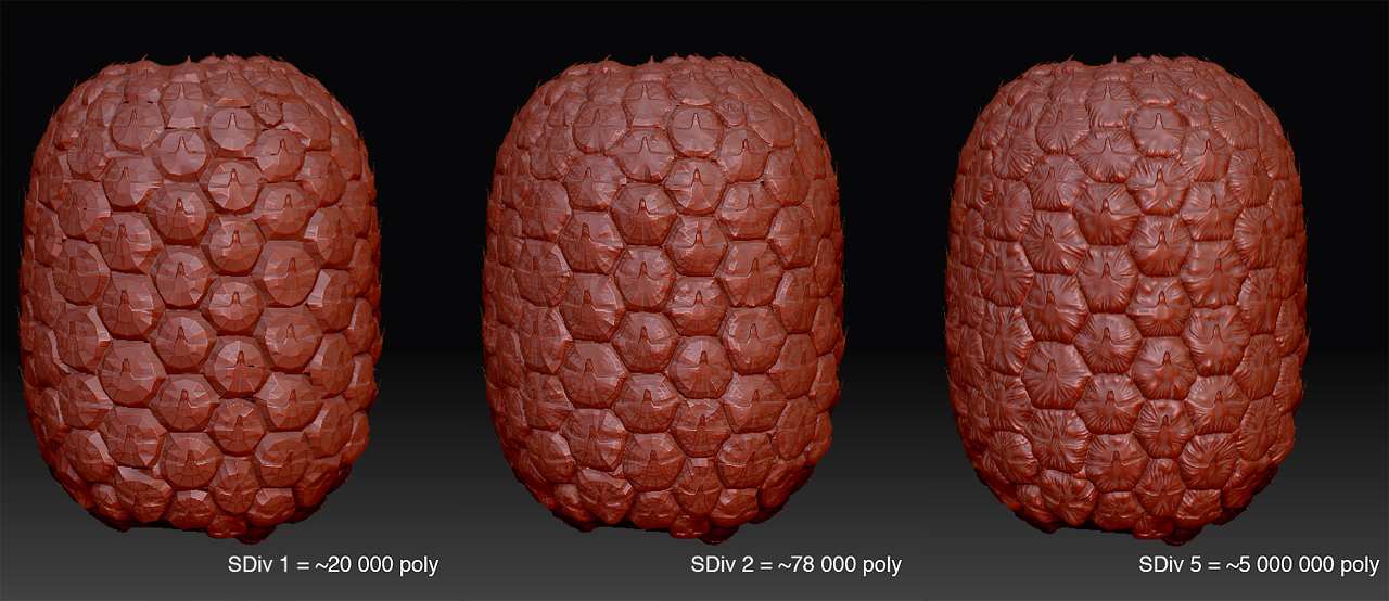

Hi, I am modelling a pineapple that I plan to use in a photo composite later, that is if it will look good enough. Attached is an image showing the different SDiv levels and also a wip testrender with a basic material and normal map created from SDiv 1. The mesh is also exported from SDiv 1.
My question is - can I export the model from SDiv2 for a more detailed mesh and then create the normal map at Sdiv 1? Or does this give strange results? (Same question about creating Displacements maps from different SDiv) Or should I always create the normal map from the same SDiv level I plan to use?

I believe that if you were to export level 2 but make the map for level 1 you’d run into problems with seams. The reason for this is that the UV’s of level 2 will be a little different from the level 1 UV’s. But this is something you should experiment with; I’ve never personally tried it.
That’s because as a rule of thumb, you want your map to be accurate for the model that you’re applying the map to. What you’re proposing doesn’t sound like that would be true.
