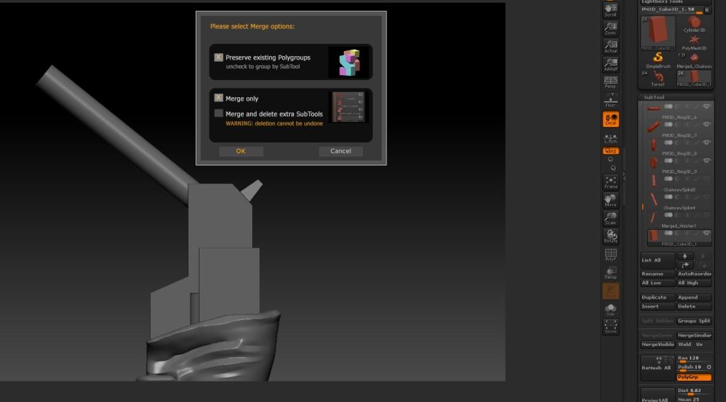

This first shot is of the subtool master selections I make.
http://i819.photobucket.com/albums/zz117/Black-Toof/1-1.jpg

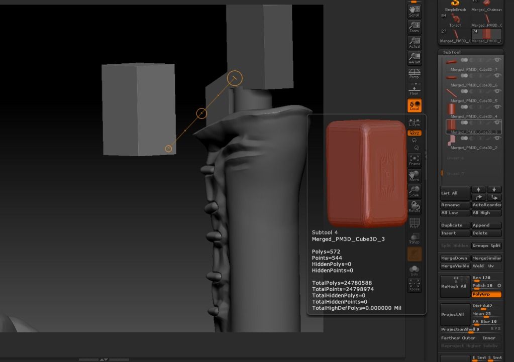

Here are all the holes in the mesh. It shows on the Subtool menu at the side, but I have pulled a piece apart and cannot find the actual hole in the mesh. If you take note of the poly count…
http://i819.photobucket.com/albums/zz117/Black-Toof/3.jpg

I don’t know exactly why the holes are appearing to the extent they are but I see that your cube is based on the parametric Cube3D. This has poles that can lead to problems with some operations. In future I suggest that you load the DefaultCube project and start with that as it has no poles. (Likewise the DefaultSphere has no poles and is a good starting point for sculpting.)
One thing you might try with your current project is to use Dynamesh to create new topology at the lowest subdivision level. You can use the Freeze Subdivision Levels feature to make sure your hi res detail is transferred.
