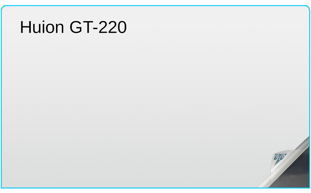

A tip: get a screen protector for your tablet monitor (I can tell you where to get one that will work for either the Huion or the Ugee)

Side note for anyone reading this who is interested in getting a Huion or Ugee tablet monitor: You can buy screen protectors for these 22 inch models from Here:
Check out their film-type comparison sheet: http://www.photodon.com/Screen-Protector-Types.pdf
I got the 6HS film-type and have been quite happy with it. There are anti-glare options as well. An added bonus is that it eliminates the squeeky sound that some people report hearing on these models when using the pen on the glass monitor surface.
