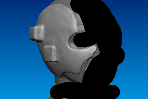

Here is an example of a shape that I blocked out with Zsketch and then re-shaped after I made in to a polymesh.
With extracting you can mask the back side off so it is not effected. extraction shapes actually are broken into polygroups too. If you ctrl+shift click (while in draw mode) the area you are working with will disappear. Ctrl+Shift click the in the area around the model, this should switch what is hidden with what is visible. Now you can work on the work on that surface with out worrying about effecting the other areas. If the object is not in groups, I think you can make it so with group split in the sub tools menu.
