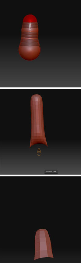

what is happening to these zspheres?
I am new to zbrush and was moving along just fine creating several zsphere figures and then I had this begin to happen.What is happening to the first zsphere? Did I change a setting or something? It seems turned inside out though it is not.
I am going to take a guess. is it because I need to add a zsphere on the bottom of the first zsphere created? Does it somehow become like a mother of zspheres and needs children so that it does not sink in like this? Now I am not sure if that is the correct terminology, but I have noticed that when I add a zsphere to the bottom and top of the first one it does not do this.
Hey there,
you are guessing right! After drawing out the root ZSphere always draw out one on the top and one on the bottom and you should have a good geometry to begin with.
Hope that helps.
