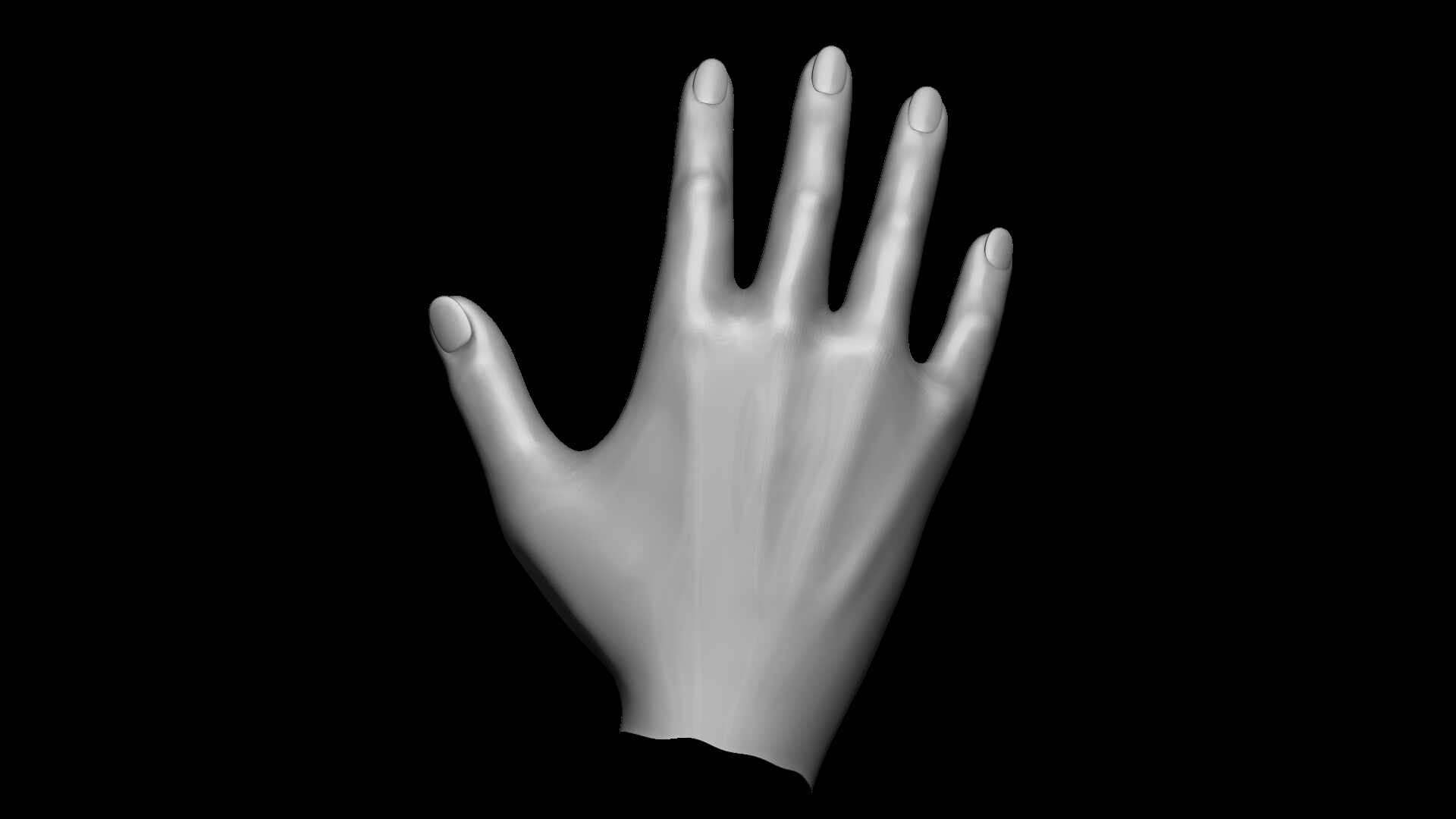

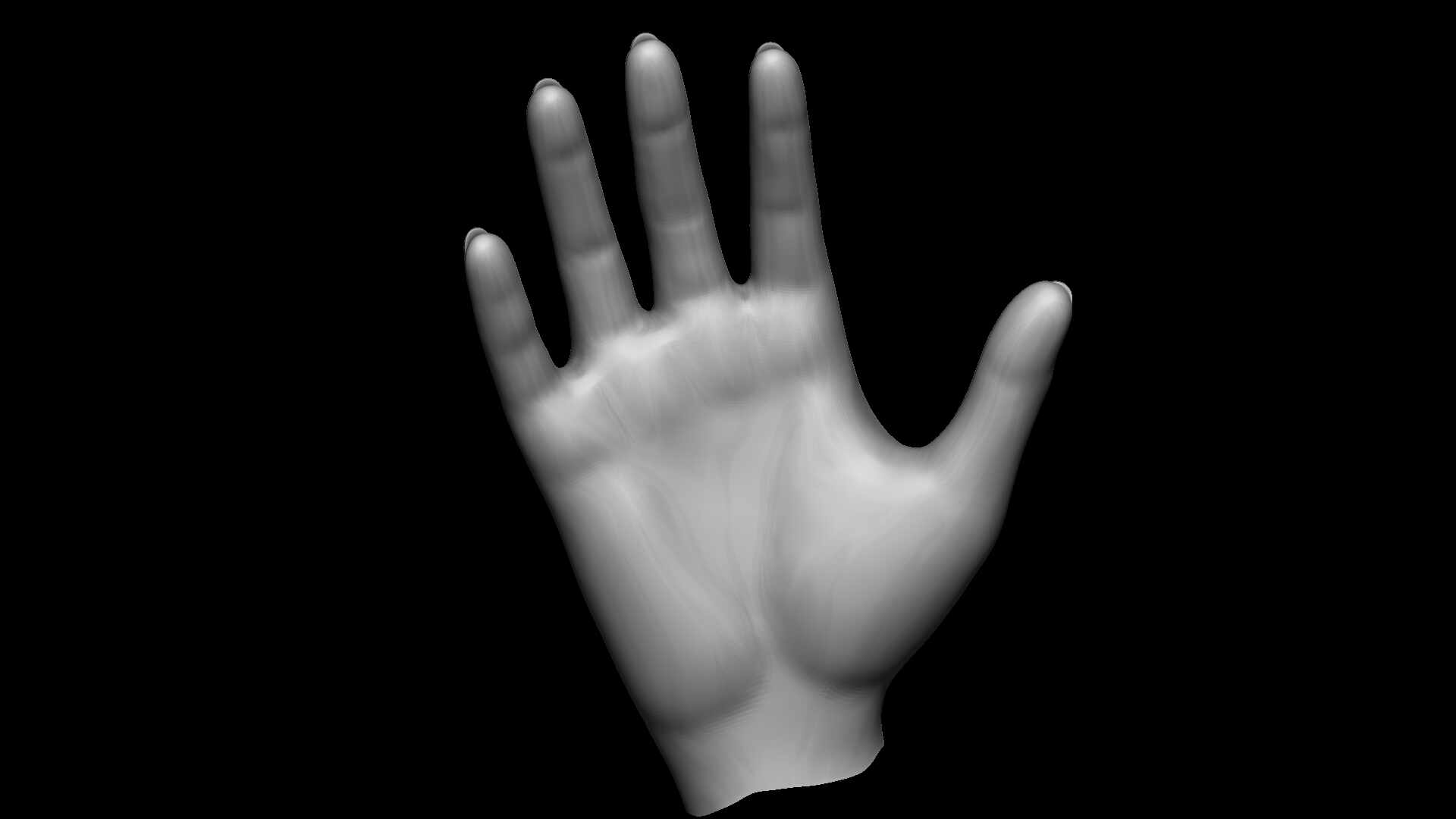

Hi. I’ve encountered this a couple of times, but haven’t been able to figure out what causes it. Whenever I’ve worked on things like hands and feet, I’ve always noticed these weird streaks/stripes after rendering with BPR. They only show if Shadows is enabled in the Render Properties. I’ve tried turning off some of the other settings that are enabled, but it doesn’t change anything.
The Subdivision levels are currently at 3 and it’s around 2-3 million points. I’ve tried smoothing the mesh down, but that hasn’t fixed it either. And I’ve tried changing the material from a Basic Material. It’s nothing major, but it doesn’t look very clean when doing beauty renders. :-\
