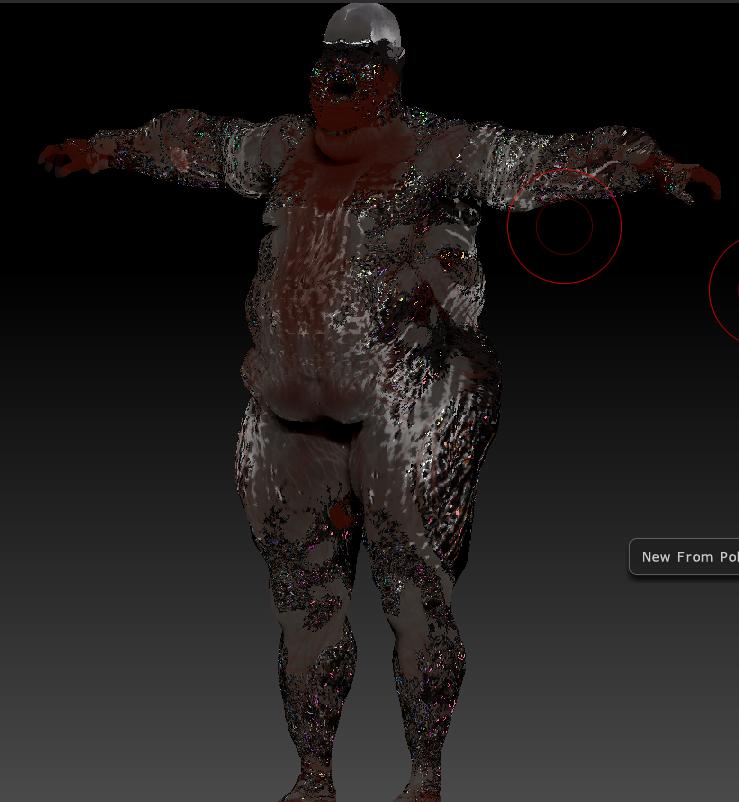

When i’m trying to get the texture by polypaint happen this or when I baked the layers i dont know what to do, any advice will help, thanks
Probably you have painted with material as well as color and then used different materials on different layers. To get rid of the embedded material:
  1. Makes sure just the Draw>M switch is on, so that only material is used.
  2. Select the Flat Color material.
  3. Press Color>Fill Object
This will mean your model takes on the selected material.
Just painting with color (the Draw>RGB switch on) when using layers should avoid this happening.
Ok next time i setup the material and later paint this.I was doing in my way i mean in the creative process testing color materials to get a result i always use the white skin material 4, but this was trying to use 2 material in some kind parts of the body, but is part of learning curve process and to your teachings dude:+1:small_orange_diamond:+1:small_orange_diamond:+1:small_orange_diamond:+1:small_orange_diamond:+1:small_orange_diamond:p:p:D:D:D
