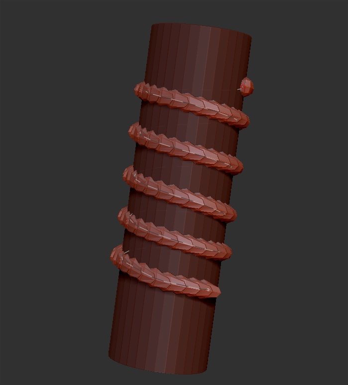

I finally found a set of chains / brush ( Thank you ) I want to use. My goal is to wrap the chains around the legs, arms and torso of my character. I have Stroke set on ā€œSnap & Bendā€. It snaps to the body fine, but when I go to move the chains it moves off of the body into the scene. Is there a tutorial or easier way to just get the length of the chains to simply wrap around a limb?

You might be just trying to do too much at once. The easiest way I found to wrap IMM brush around a cylindrical shape is to have Snap and Bend on and draw a short piece at a time. Keep rotating the view and extending the curve a little piece at a time. The way you extend the curve is, move the cursor close to the end of the curve and you will see a red line snap to the end point. When it does that, keep drawing to add another short piece. Keep doing this a little at a time as you are rotating the view. It also helps to use a small Draw Size on your curve edit cursor (Stroke > Curve Modifiers > CurveEdit Radius). After a while, you’ll get really good at it and find that you can move along quite quickly. You can read more about curve usage in the ZBrush4_R4_whats_new.pdf (pages 20 - 26) in the Documentation folder of your ZBrush directory.

Whoo hoo! I finally achieved it! :slight_smile:

Once you are finished with the first curve, click once on the underlying mesh to delete it which will delete the curve but leave the chain on the mesh. This is the same as going to ā€˜Stroke > Curve Functions’ and clicking ā€˜Delete’ button. You will now be ready to draw your next chain.
