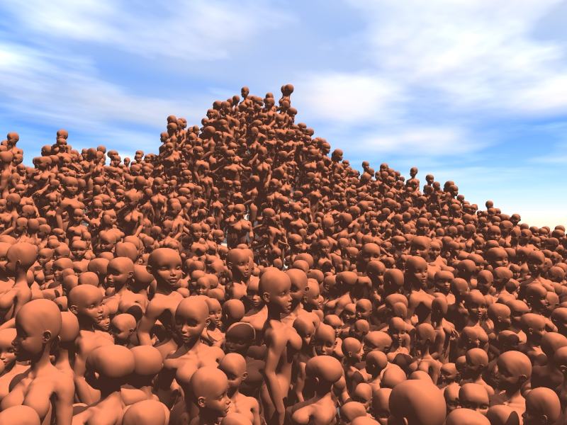

here a pic (nudity! :slight_smile: )with girl from poser modified in zbrush -export as an .obj and make some ecotest in vue (400 mill. polys!)-
souleat, in vue 5 you can import a poser 5 file.
According to what I have been reading vue will not
as yet import a poser 6.
You exported from Poser as obj file, into zbrush as obj file
and into vue as obj file, this should in theory work all the time.
Problem with poser as obj is hair, clothing, texture, etc.which as
obj file does not compute.
“this should in theory work all the time” :smiley: -Yes but theorie and practice arent always the same! so i make a test (the poser figure only to have fast an big object…)
i know that the textures (for poser figures) are a problem but i use always a
cleaned figure (delete the innermouth,teeth,eyelids … in other 3d prog -most TS 6.6) and textur new in zbrush.
want to show also the new ecosystem which is really a novity and very usefull!
(altough you can paint also thousands of objekte in zbrush but the Antialiasing…
and positioniering is slower)

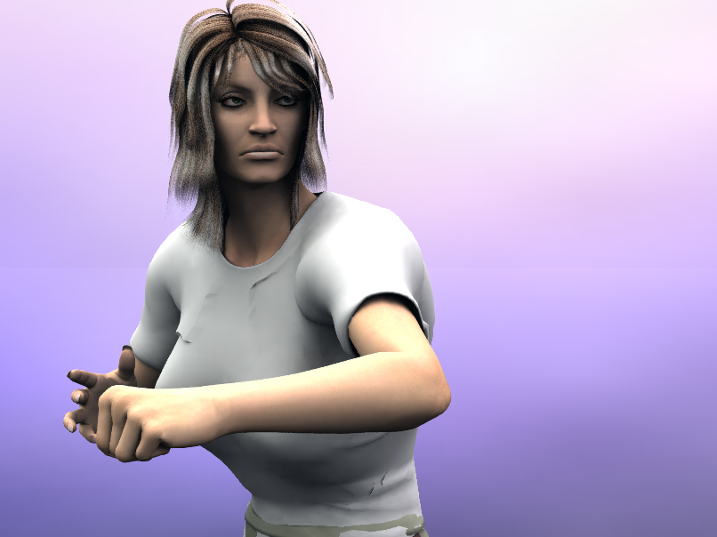

Up front, let me thank my hosts. This is a zbrush forum. What I will try
to show in no way involves zbrush.
Also, I am not an impartial judge, have done daily comparison tests for weeks,
This interests me greatly, I truly want Mental ray and Maya to render
these scenes the best for selfish practical reasons.
I created an average figure in poser, with texture, hair, etc.
Imported that figure into Vue 5.
Used the same image for it’s image based lighting feature ( my own)
Render was at an average setting. No tweaking of brightness, quality, etc. No light was moved or adjusted. What you see is what I got.
Render time was about 10 minutes. The image could have been improved immensely with tweaking, but that would not have been fair to the test.
Also on both these images, no after work whatsoever.
Under the name bicc39 at renderosity there is basically a collection
of crap.
There are however three or four images using Vue that I like.
The only thing that they have going for them is the quality of the renders
from Vue 5.

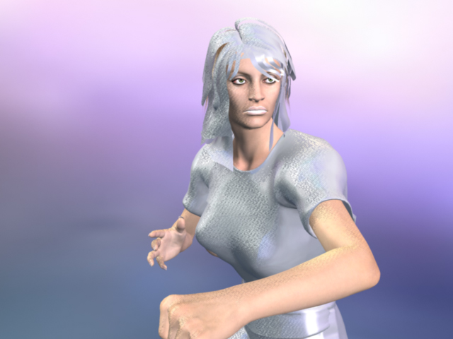

I will repeat what started this in the first place.
Vue 5 is a fairly good investment for it’s rendering capabilities alone.
