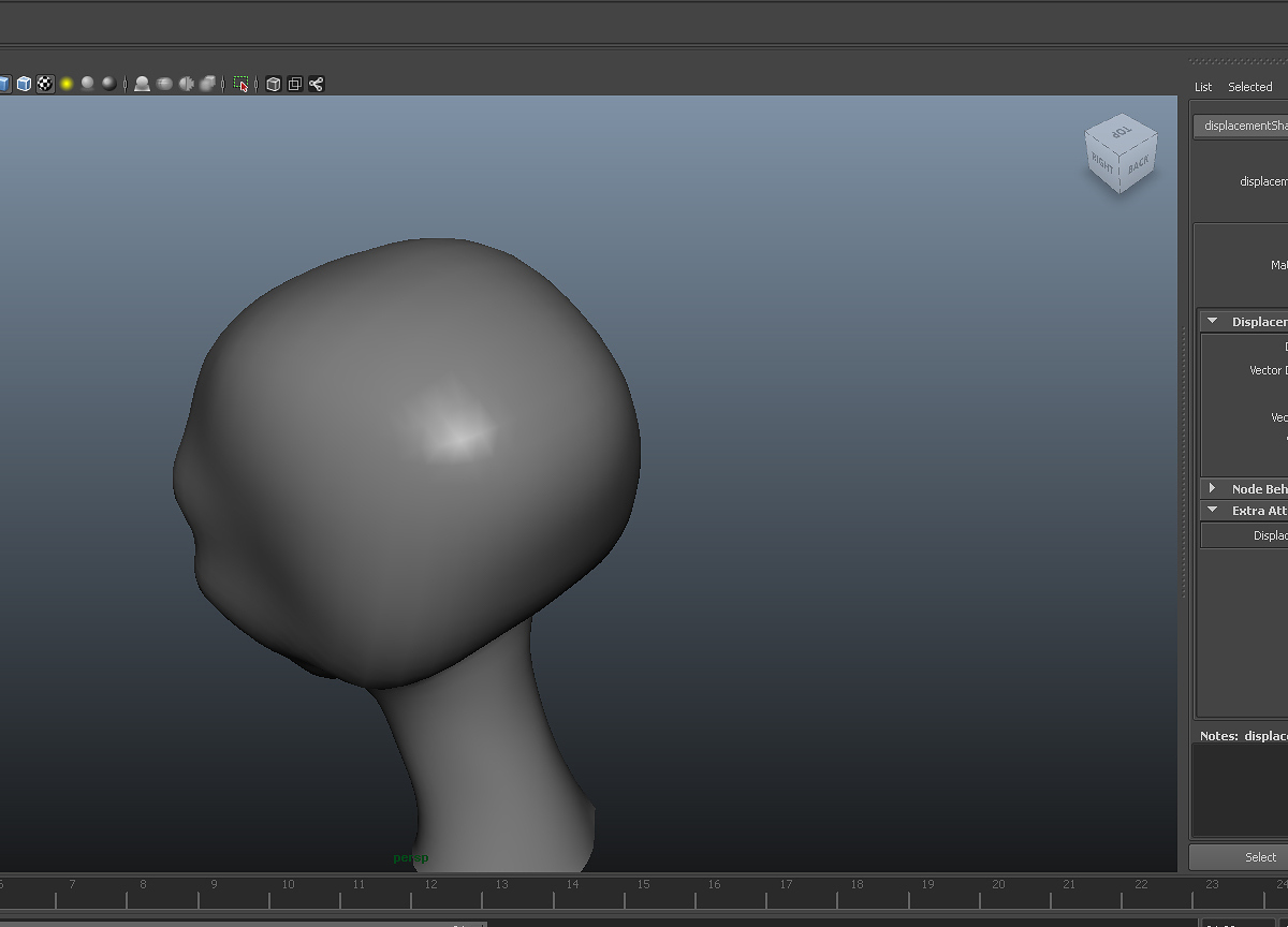

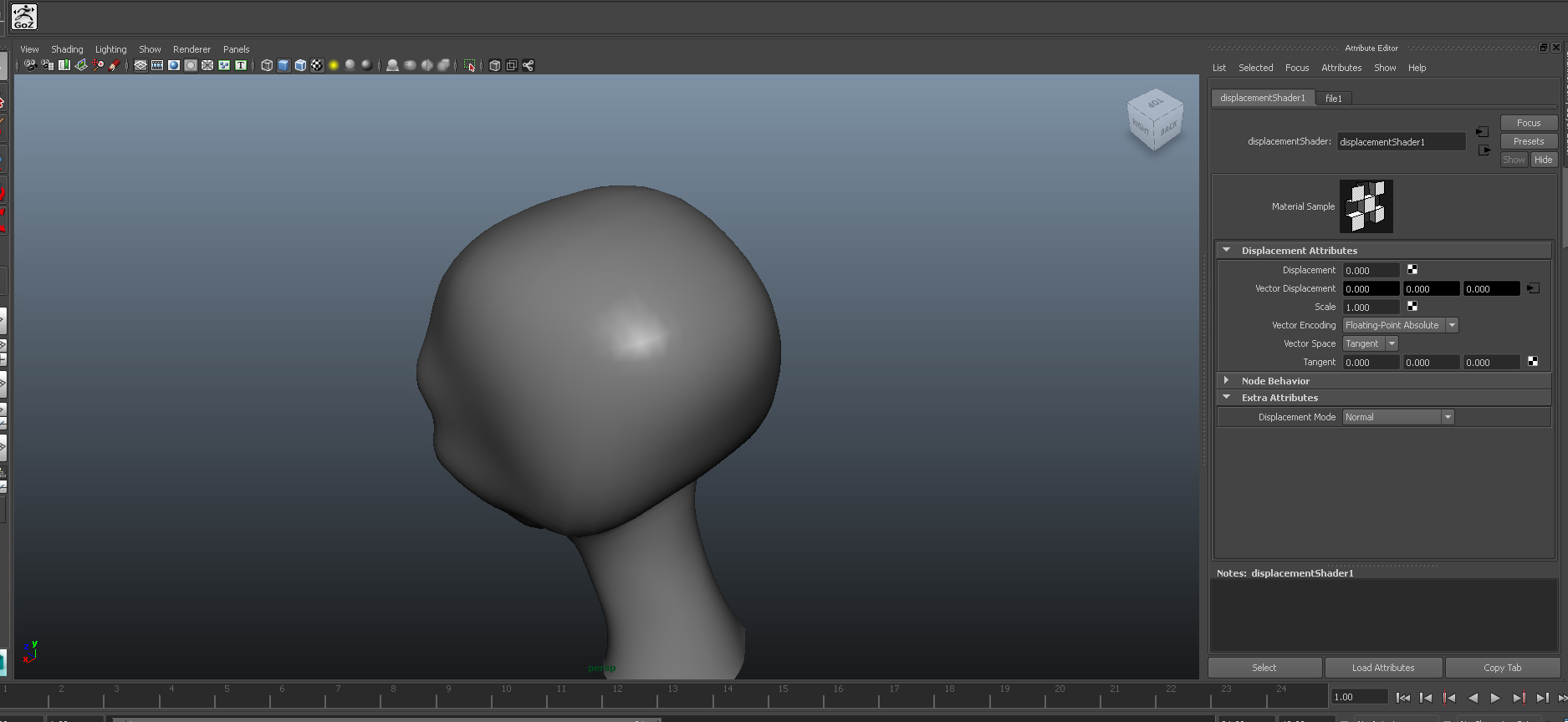

I am using Maya 2014 with Mental Ray, creating vector Displacement and normal maps in zbrush. Have setup the tangent switch accordingly. made sure I had some buffer around my uv seams when creating the maps.

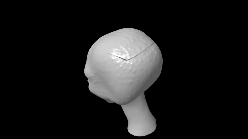

And I get seams rendering in maya along the uv borders.

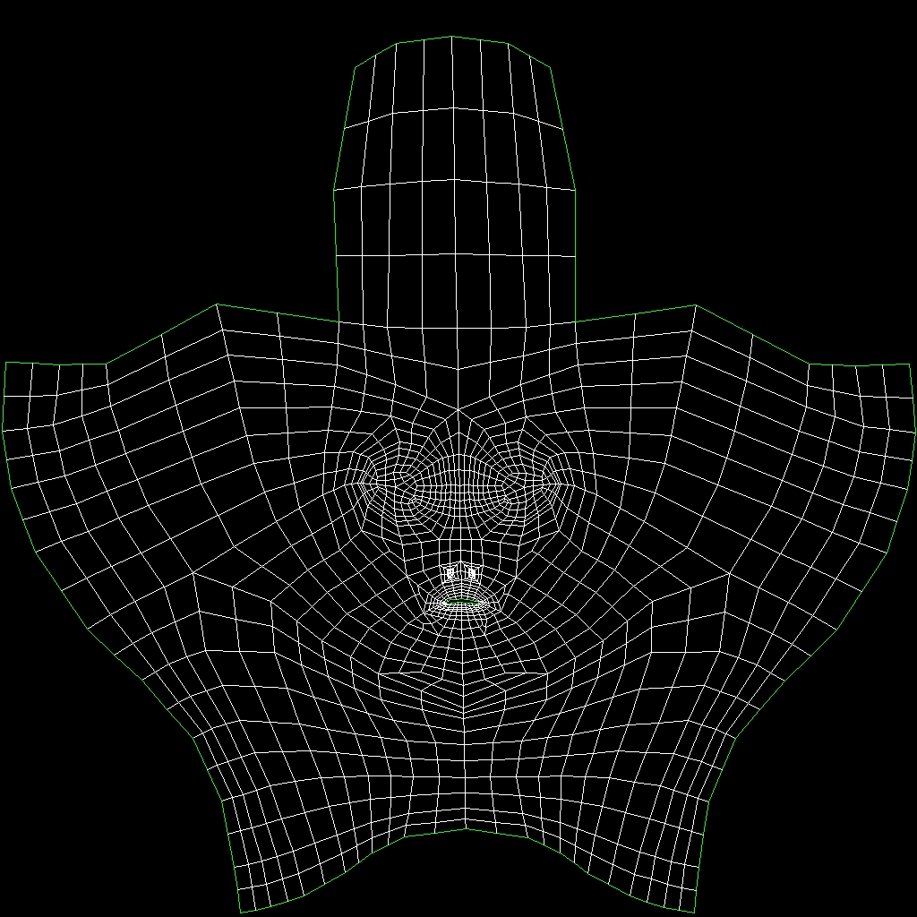

My specific case is a head that I laid out the uv’s using unfold. They are cleanly laid out and the maps that are created do not appear to have any artifacts to the naked eye.
