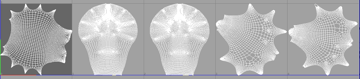

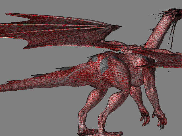

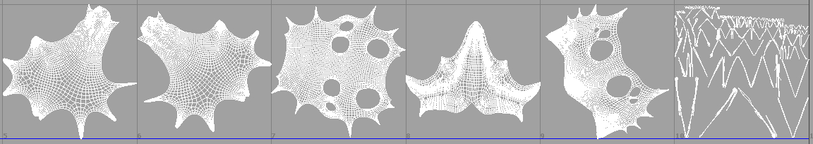

Hi all. OK, I’ve been at ZB for a month or so now. After a few tries I’ve managed to create a dispacement map, and am now moving on to the bump map (using bump viewer material). I’m not quite certain how to describe what’s been happening with the UVs. I’ve experienced a LOT of crashes, which we’ve narrowed down to being an overlapping UV issue. Quite often we’ve had to pull the obj. back into Maya, check uvs, & import back into ZB. I’m not sure if that’s got anything to do with the horrid vision I get when I click ‘UV Check’.
[![overlapping uv.jpg|640x480](upload://7l957bR5dTPxqHDivajnMa79f7L.jpeg)]![uv groups.jpg|640x480](upload://5sJFVSpsprUXYwoTzcOY4vvJDmY.jpeg) Has this ever happened to anyone else before??

i 'll put myself out there and say the problem is probably .yeah .the uv groups .as far as i can tell the only real support beyond 0 1 is with the multi_displace .and zmapper ( making visible only the uv group you want to generate the normal map for ) .the uv check i think interprets all the groups you have as being stacked upon one another from 0 1 .that 's a bunch of overlapping from it 's point of view
i seem to recall reading somewhere that to work outside of 0 1 with projection master you have to :
make visible only one uv group at a time .paint your whatevers .and export the map for that group
rinse .repeat
obvious problem would be then a .you can 't paint across your seams .so .if that 's what you 're trying to achieve it 's likely crashing trying to figure out where to put that pixel
don 't quote me on that though .i 'd accept being totally wrong here .i 'm far from an authority .what i do know for sure is that i 'll steer the f__k clear from PM for anything but displacement with alphas .to my taste it is far too clumsy an affair
