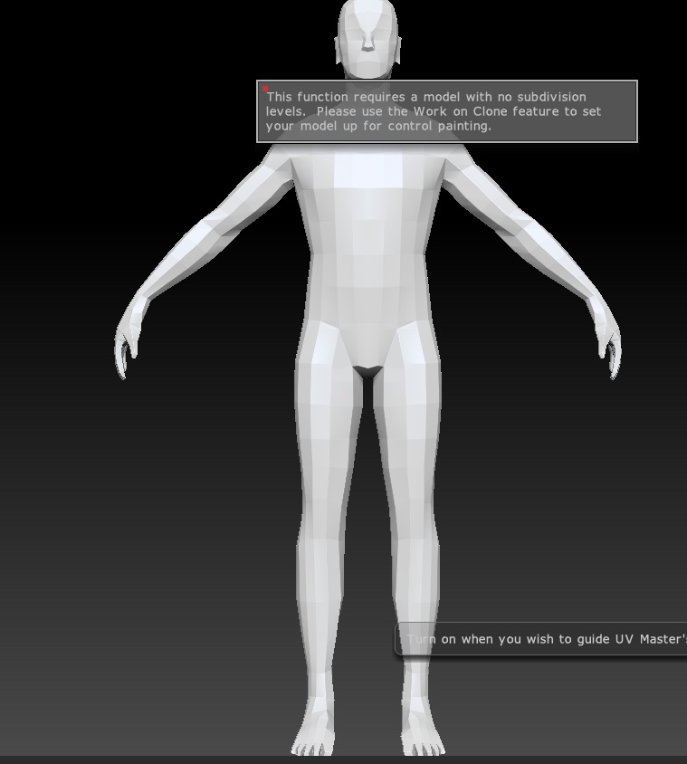

Hello everyone, I am having issues with the UV Master. I followed the tutorial to the T, and when I try to flatten, or paint the UVs on it says that the model cannot have any subdivisions. However, I’ll use the demo soldier, and he has subdivisions, and it works. My model has 7 sub divisions, I’m not sure if that has anything to do with it. Any input would be helpful! Thank you!
Can you post a screenshot with UV Master open and the message ZBrush is giving you?
<img src=“http://www.zbrushcentral.com/pixo/atn.gif”>

That’s the way UV master works. Somebody correct me if I’m wrong, but I don’t see anything out of the ordinary here except operator error. You create your UV’s on the clone because it has to be on the lowest subdivision level to do it and you can’t have any higher subdivision levels. Once you create your UV’s on the clone, you click "Copy UVs’ in UV Master then switch to your other ZTool with your 7 subdivision levels, switch it to subdivision level 1 then go to UV Master and click ‘Paste UVs’. I believe those are the instructions in the tutorials. Haven’t seen them in a while so I might be wrong but I don’t think so.
Its probably user error :lol: But I will try that, I know I’m doing something wrong. Let me mess around with it. Thank you for your reply I appreciate it!
