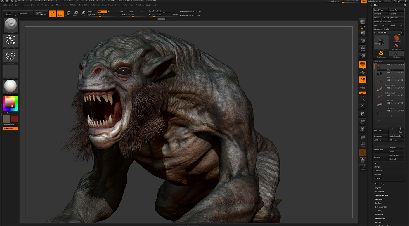

I’m trying to follow a tutorial but running into a problem. I have this guy textured and am ready to set up some maps. I bring him to the lowest subdivision level, go into UV Master, and click on “work on clone”. But the clone comes up with all the subdivision levels. Is it supposed to do that? When I try to use protect and attract it says I can’t due to multiple subdivisions. Any ideas? I’m uploading the picture just in case you might be able to see something I’m missing.
make sure your masks are cleared, and try to make a clone again inside of UV Master.
If that doesn’t work, save your tool (tool.save as).
Initialize Zbrush and load your tool.
Hope this helps.
Once I’m in UV Master is just deleting the higher subdivisions on the clone going to adversely effect the process?
Still had a layer in record mode. :frowning:
