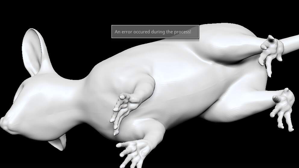

UV Master not working
I always model a base mesh in external app and import then subdivide and add detail. Paint texture, job done.
I wanted to be one of the cool kids this time and just modelled in zBrush - never again!
Can’t create subdivisions, can’t create UV’s, zRemesher just loses all detail despite adaptive size being set high.
All this work lost - I have exported and fbx, will create a base mesh in Maya and redo all this stuff. What a waste of time.

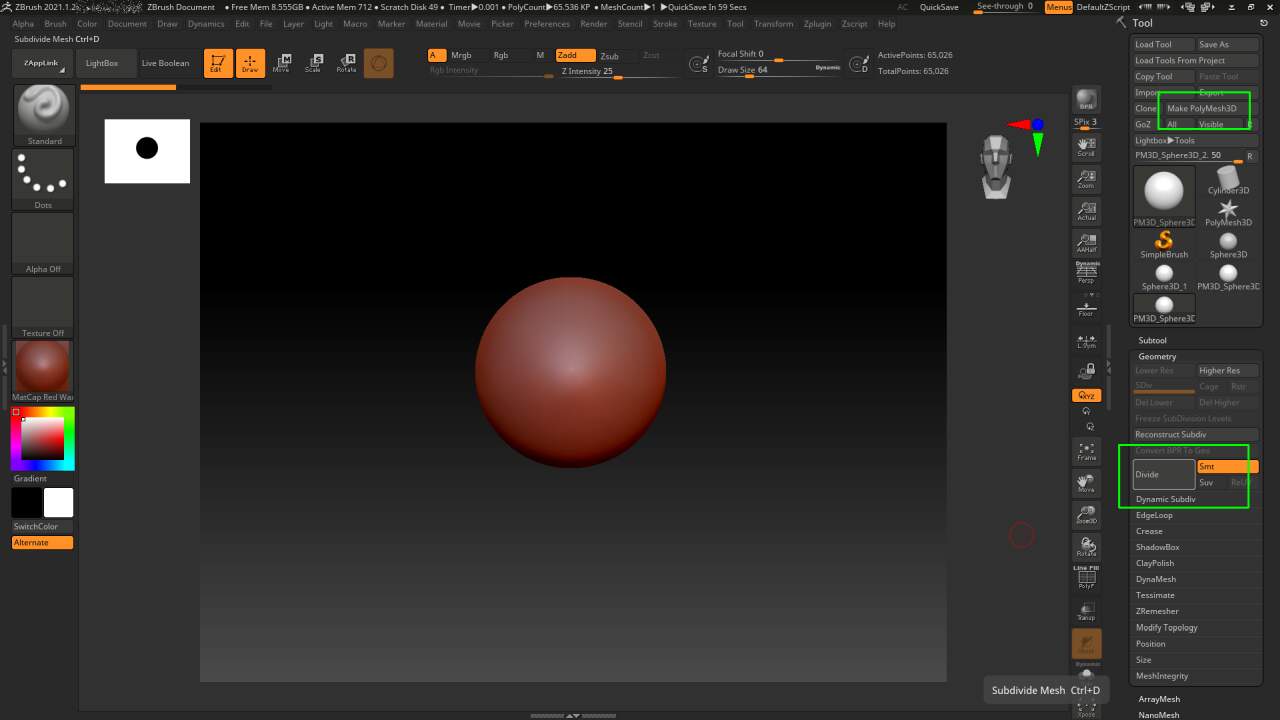

Once you added a primitive form and you want to sculpt it the first thing to do is to convert it into a polymesh, you can do that with the option in the tools pallete; by default this is visible on the right side of your screen.
After that you can use the divide button to subdivide. I marked that as well, you just need to expand the Geometry section.

I am curious in what context you experienced the error message in your screenshot, however. Was this the result of trying to use UV master with a high resolution mesh?

can’t recreate subdivisions - that was how I was trying to recreate a low poly mesh from the sculpt. The sculpt isn’t that high 180k but preferably would like a subdivision or two less for the base mesh and UV creation.
The model was started from a couple of primitives, merged with unified skin and zRemeshed heaps of times. I ran UV master a couple of times during the process and it worked fine, sadly just not any more.
The mesh is consistent quads and looks pretty good really, I can’t see any reason why these features shouldn’t work.
