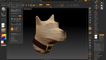

Made a simple Maya base model and roughed it in Zbrush (example image is below, super simple. No UV’s)
brought it into Zbrush 2018.1, this happened a few times in 4R8 as well on random machines not always though.
built the model up then dropped to Sub lev 1

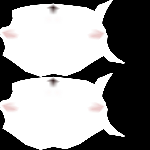

Went to Uv master to unwrap using default settings. Unwrapped
created two islands with messed up seam uv’s, i only wanted one island. Which has always been normal.
removed the Uv’s used the enable control painting function. Painted my seams
Unwrapped again, two islands again. I also noticed that it stated two polygrops (polygroups isnt enabled in uv master.)
cleared Uv’s again
Merged all polygroups, just in case. Unwrapped again, two islands again.
So i decided to go and grab the original super low rez base mesh (with no Uv’s) and its an maya exported .obj with everything turned off if anyone’s curious.
Unwrapped it with default settings in Uv master, two islands again.
