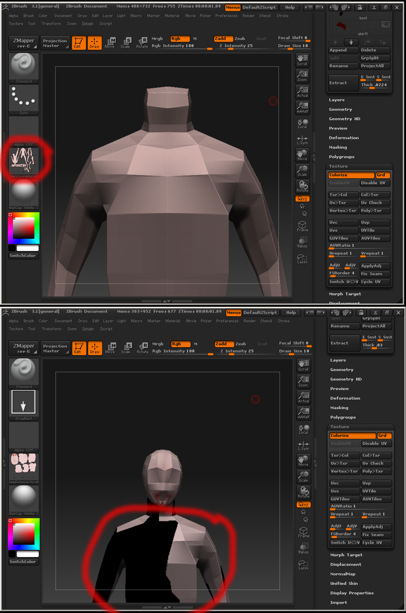

Okay so I did a quick test, and it didnt work, not the way I want it to.
I have included the images.
The first is when I apply the col-txr for the body. Looks okay to me.
Second image is when I try to apply the col-txr for the head, and the body turn into black areas.
That should not happen. Right?
