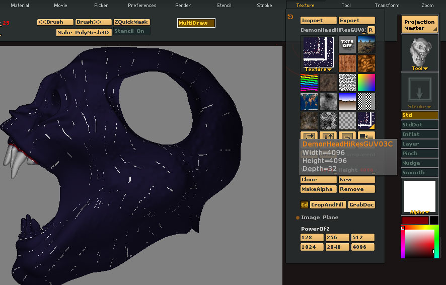

Here are the results:
:large_orange_diamond: load tool
:large_orange_diamond: Draw tool on canvas > Edit mode
:large_orange_diamond: create 4096 texture map
:large_orange_diamond: GUV Tiles (takes about 30 min to generate)
:large_orange_diamond: Drop to PM and paint
:large_orange_diamond: Pick up:double sided:ON / Fade:ONZBrush_GUVhelp02.jpg
What if someone else provids a mesh like this to texture,(besides firing them…) just trying to understand work around for this situation.
If used for animation would you have to rebuild a low poly mesh anyway, but unless the UV mapping is correct, a displacement map from this would not work?
