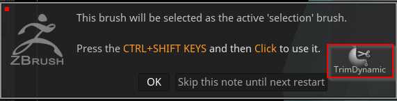

Hello… I think I’ve found an issue… When using the script all my Trim brushes change to slice brushes and even the icon changes… I get this msg and I can’t use the brush as I normally would.
Hi Ed209,
Thanks for pointing that out and I’m sorry for the problem. I’ve corrected the plugin but you’ll need to restore the TrimAdaptive/TrimDynamic brushes from your backup.
