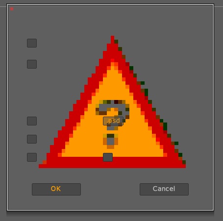

works fine but…
Same here :frowning: I don’t even know how to save the sequence, as i can’t see the options, like shown in the previous post. At best i get an error msg saying “Unable to save” and pointing out the TurntableData folder for some reason.
Tested on 4R5, maybe that’s why
Hi guys,
Apologies for the problems. Download the 4R3 version at the link on this page:
http://www.zbrushcentral.com/showthread.php?94752-Useful-small-ZScripts-and-Macros-for-ZBrush-4-amp-4R3&p=759928&viewfull=1#post759928
The version you have has a missing data folder which is why the images don’t show. If you are using BPR then you can ignore the options in the dialog box as they apply to Best render but you’ll need to click OK so that the Save dialog appears. I hope to update this for 4R5 soon but it needs a bit of work and I don’t have time at the moment.
