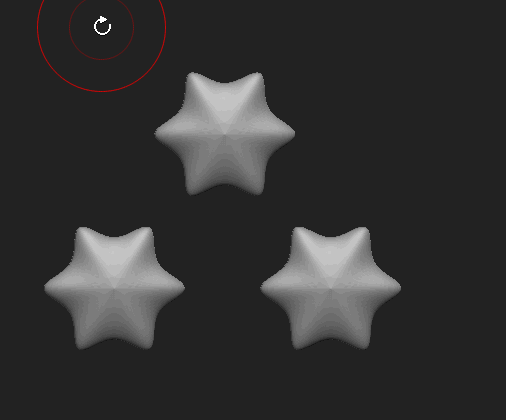

Here is something I made recently. Pretty basic compared to some of these guys :slight_smile:
It takes your currently masked geometry and duplicates it WITHIN the same Subtool. Similar to 3dsMax duplicate to element. It works with a fully masked element or partially masked geometry.
I made this because I was placing 4-5 different spikes all over a creature. I didn’t want 100 Subtools to manage and wanted to duplicate different ones as I went.
OOOoooOOO!!! THAT looks handy! Thanks!
So this seems to work with subdivs for single levels or dynamesh people can just use Duplicating_a Mesh with Transpose
unmask what is to be cloned press (W) Move:transpose line and (Ctrl+click) on the Center red circle to pull out another instance of the unmasked polys within the same subtool.
