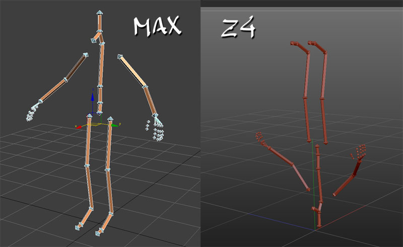

Is it just me or anyone else is getting upside down models between max and zbrush4?
Im just simply exporting from max and importing in zbrush 4 as I always did in Z3.5 and I never had this problem
what am I doing wrong?

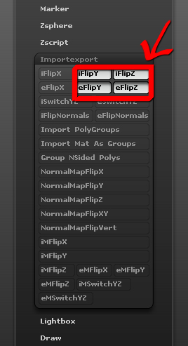

I figured it out … these options need to be on
