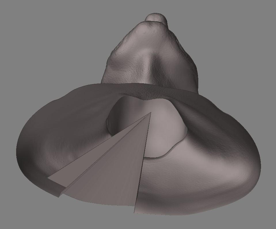

Hi all,
Ive got something strange that appears inside my model, any fix-it ideas out there?
its not on the low levels of the model, but certainly gets worse when i carry on with the model in projection master, its like there is a gravitational pull to the inside of the head , which is ok for a few drops, till they go through the head like giant splinters- oh and it got worse when i pressed GUV tiles before i start to paint??- ive tried deleating higher levels then dividing again but those splinters and pyramids keep coming back!!

they’re just stray verts, just start to smooth them down,starting at your highest level of subd’s then go down when you’ve finished on that level.
smooth is weird now for single verts so you have to have like an open canvas behind the vert, so you may have to hide the head and look up through the neck as your pic shows now.

ive been having success with smoothing some of the smaller ones,
i do get the odd one thats about 50 feet long, which are a little harder to handle,

Remember that you can also use Move to move the stray points pretty close to where they belong before you start smoothing.
