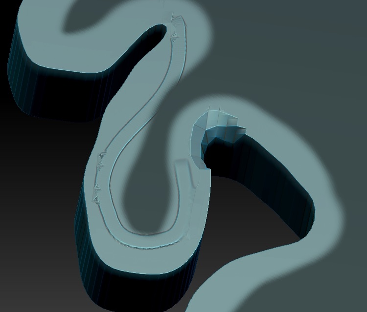

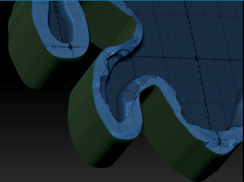

another shot
I made a cylinder 3d
made a mask
extracted the masked
divided to 2million polys
masked the edge of the extraction

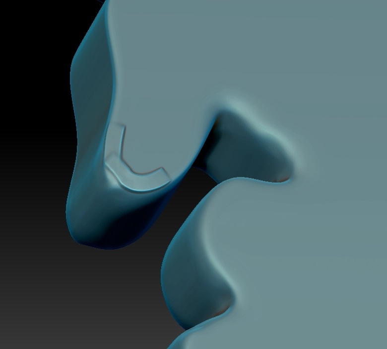

tried to sculpt and smooth and got those pixelations

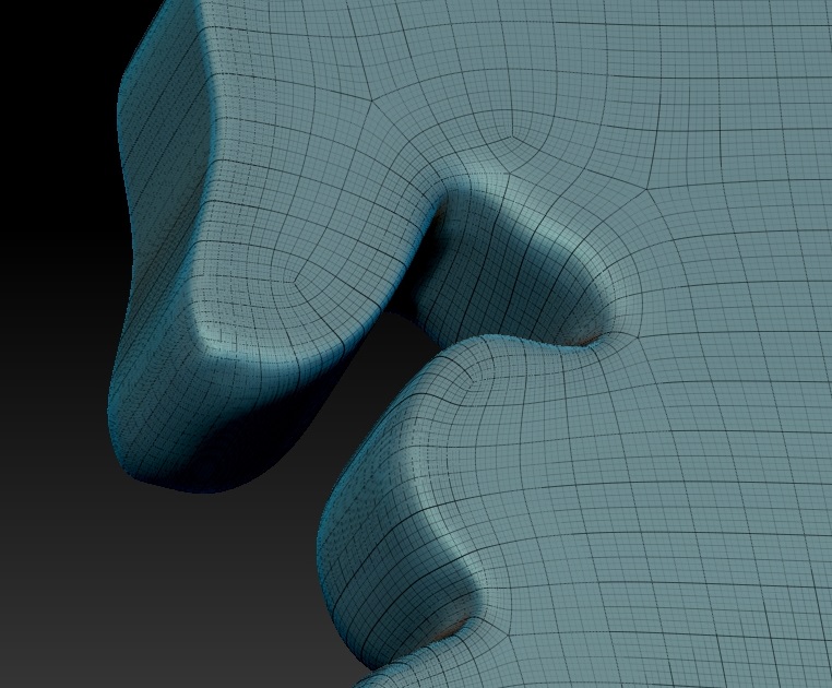

why are the edges pixelated

I was trying to add detail to the border

tried the backface masking, didn’t change anything, still cant sculpt on the edge of the part
ok I used zremesh and it fixed it up nice for me so that I can now sculpt the corners, even rounded the corners like I was going to want later on anyways
