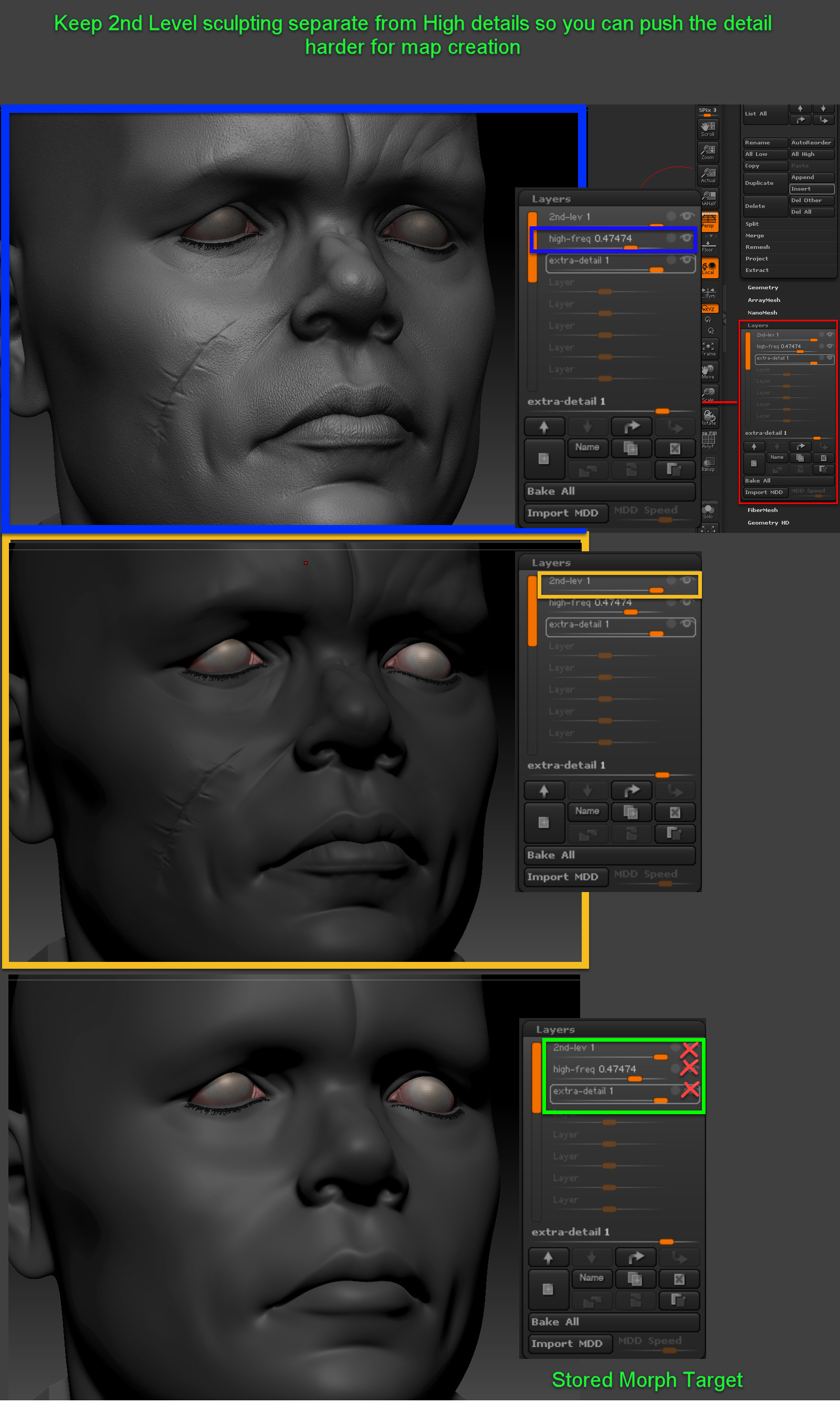

Sculpting:
I store the original state of the base mesh within Zbrush using a feature called store morph target. I then sub devide and sculpt base secondary level forms which does not include high skin details. I then on another layer sculpt high details.

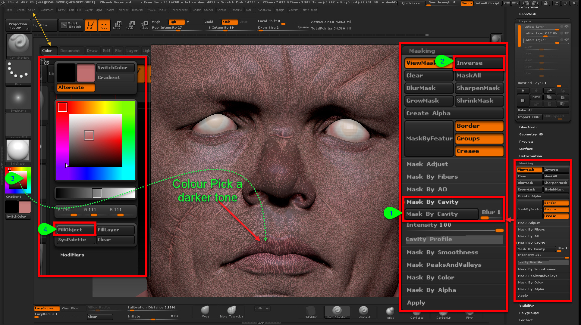

Painting:
In Zbrush I project paint a photo, this will not be what I use in the render but I use it as a color pallet in which I use the colour picker to hand paint over the mode. By the time Im finished there will be no photo projection left other than the odd patch here and here.
The reason why I dont use photo projection for my final is because I want the skin sculpting pores to match the diffuse colour, and being that I dont use the photo projection to extract skin details from, and use XYZ textures for displacment detail I do the following.
1: Finish hand painting model. Use skin detail layer to mask by cavity, inverse mask and fill in with darker tone. This then makes the diffuse colour complement the real skin details.
