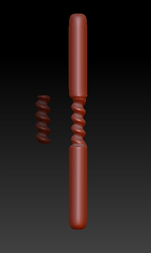

Do you actually need twisted geometry? If not you can make a piece of twisted geometry seperately with deformation tools and project the details in the area you need it:
