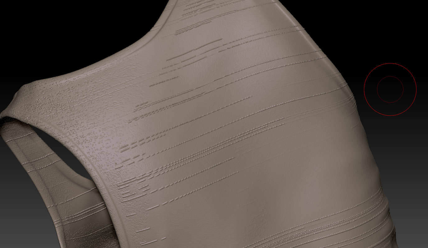

I’ve been testing a bit more, and the problem really seems to be transpose master. Any tool that has been used with transpose master will have this problem. I’ve even tried exporting the 1 subdivision and importing it to a new layer in a file previous to that transpose data, and the problem appears again. Everytime I unpress the rec button, it adds noise, and the more I press and unpress it, the more noticeable it gets. Here’s an example in the image, all those lines and dots are being created when I unpress the recording button in that layer.

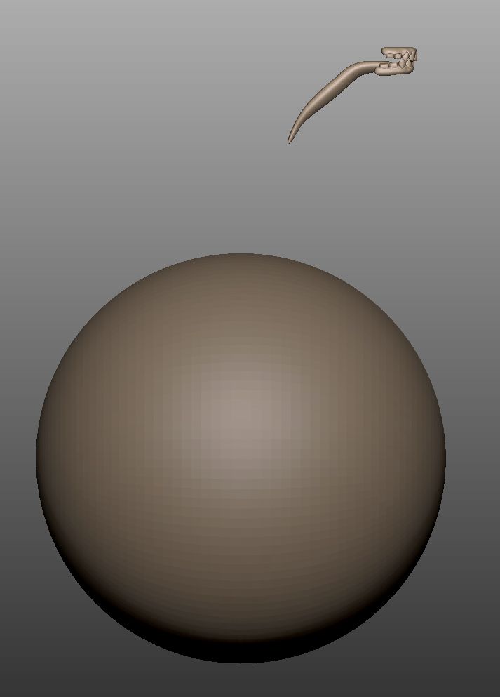

On one old post, Aurick said the scale might be a problem, so here is the scale of my tool when I append a zbrush sphere :
Any body knows how to avoid that?
