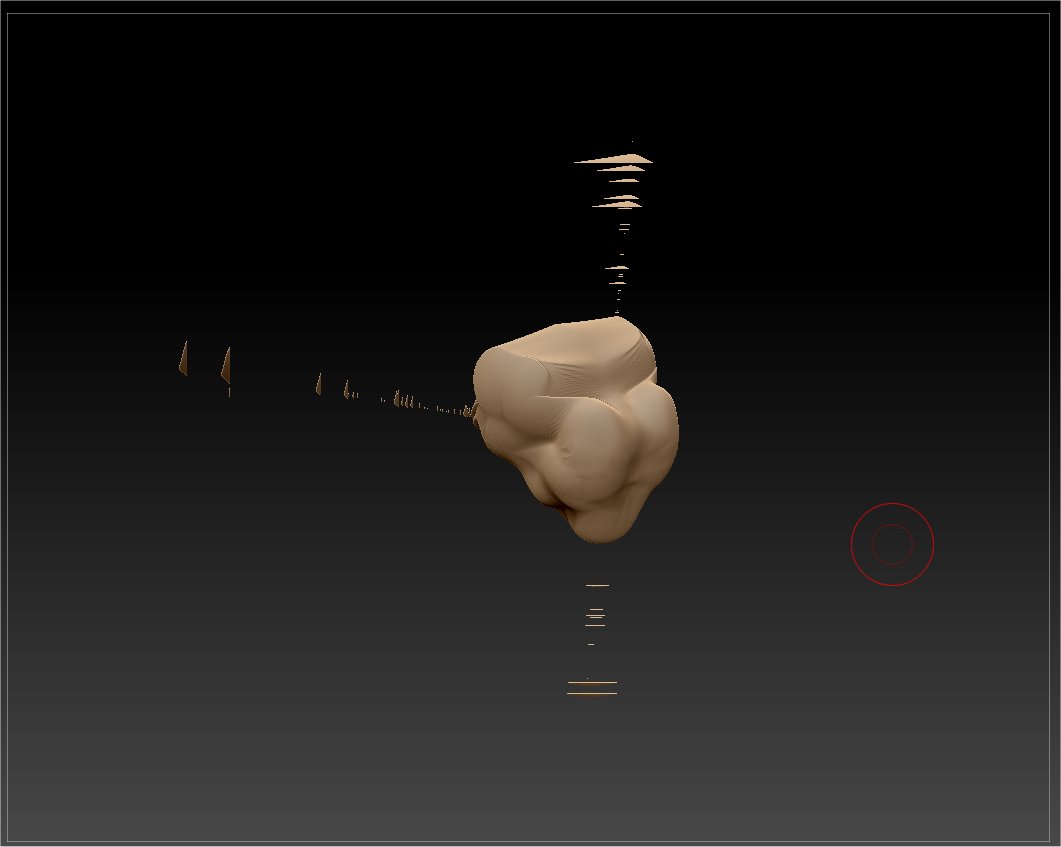

im new in ZB3.5 r3… all is very very nice i love it!!! but… i have a tiny problem… i start to modeling… but if i “Zoom in” my Object and then “Zoom Out” it repeat some borders like an echo i think it happens when the model have Sharp Borders. (see image)

Het there,
do you use the icon on the right hand side to zoom? If so … don’t. Use the Alt key click and drag, while still dragging let go of alt. It’s the better way to navigate and you won’t have those artifacts on the screen. Somehow the artifacting only occurs when using the icon.
Hope that helps

ehmmmm yes!.. i was working with the Zoom icon :o
WOW i did try with the ALT Key!!!.. Everything Work Fine!! NO MORE ECHO… and i will try in a few seconds the Macro tutorial…thanks for the link… You Rock!
