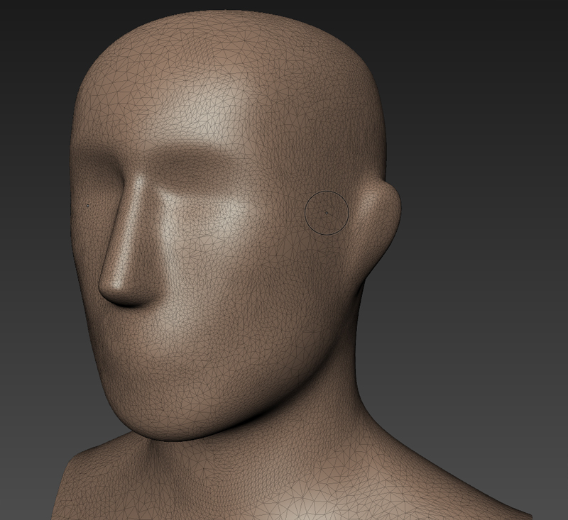

This is the decimation done in mudbox.
notice how the triangles are somewhat uniform in size. I want to be able to achieve something similar in zbrush.
are the two decimated to about the same poly count? the mud box doesn’t look like it’s decimated all that much.
i get similar type geo from DM after i’ve used zremesher. that gives the object more adaptive geo lines than dynamesh which DM seems to do better with. i don’t think you will be able to control the size and distribution of the tris directly with sliders.
