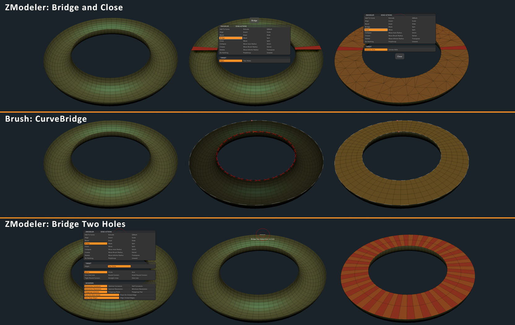

Here are three options, entirely in zbrush, that take less than 10 seconds each.
https://i.imgur.com/OD5sFj2.jpgkCl9Jsp.jpg
