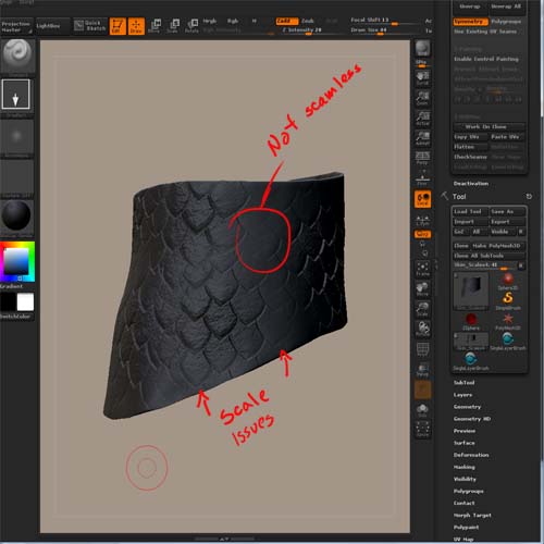

Hello, I was wondering if I could get help with this. I am tring to get a snake skin alpha around my sub tool. The issues I am having when using masking or projection master, are scale and seams. I have been using the drag rect with ZInt of 20 and the Alpha has a Radial Focus of 100. What is the best way to approach this? I have searched through ZBCentral and found links to issues with creating seamless alphas but not applying them to a cylinder. I appreciate any help I can get. Thanks

What I was hoping to achieve was a snake skin that would be wrapped around the mesh. The results I am getting now are showing overlapping where the alpha was dragged out and not lining up to its previous placement. In the highlighted image the circle is showing this, but also is evident near the bottom left arrow. Also being that it is a cylinder the alpha tends to enlarge on the sides when going around, hence the scale issue. From where I start ,with the desired size, the snake scales increase in size greatly when i go all the way around.
