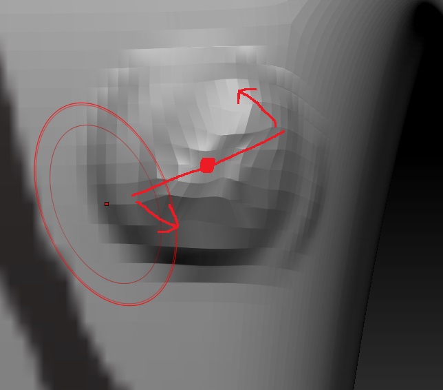

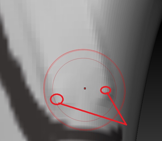

Hi, the image to the left shows a split in the brush, that is one stroke and it looks like I done two small ones parallel to each other. Why is that happening? When the tutor does it with the trimdynamic brush it just looks like one big thick stroke, which is what I want.
The image to the right; I have marked the pivot with a red dot in the middle and the width of the brush marked by the two red lines coming from the red dot. I have also marked the rotation of the brush with the red arrows. When I hold down the mouse with trim dynamic brush selected, and accidentally make a circular motion, this happens and it causes a swirling effect on the tool. Is this supposed to happen?

You can adjust the profile of the brush by adjusting the Brush>Curve>Edit Curve, though I think some of what you see is a result of the material shading rather than actual geometry.
For the circular motion, this can happen with irregular circular motion where the brush builds up on previous strokes. I’ve no suggestions, other than to work slowly to avoid doing it.
