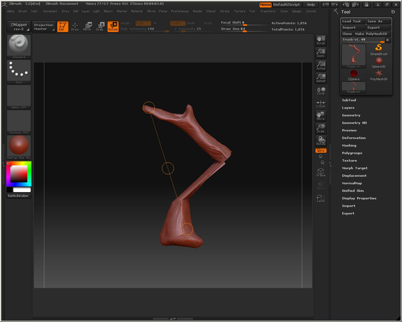

I think I may be having a similar problem. Many times while using the Transpose tool my mesh will be torn apart - part of the mesh moves as expected but the rest is left behind. This can happen with or without masks, in subtools, polygroups, etc.

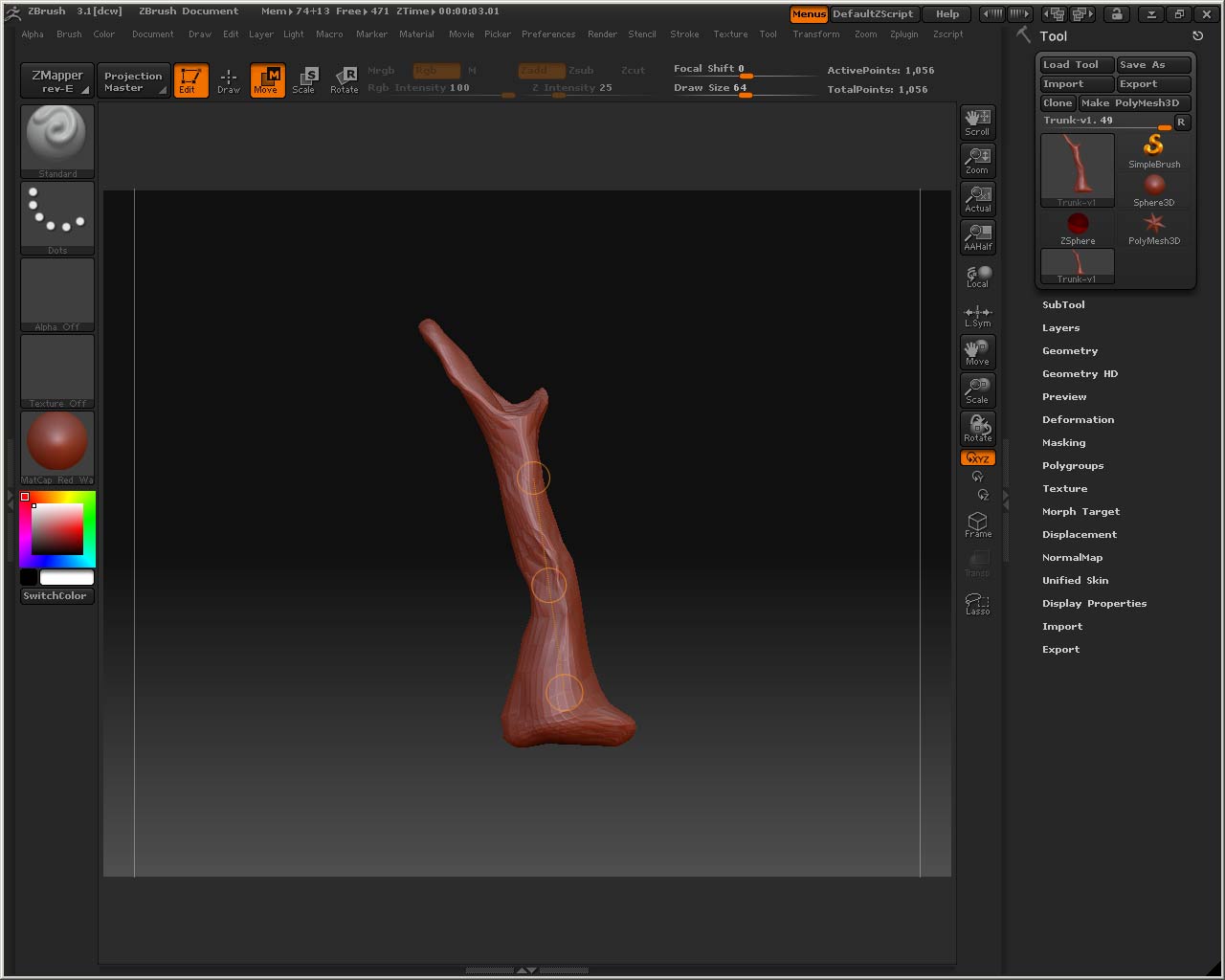

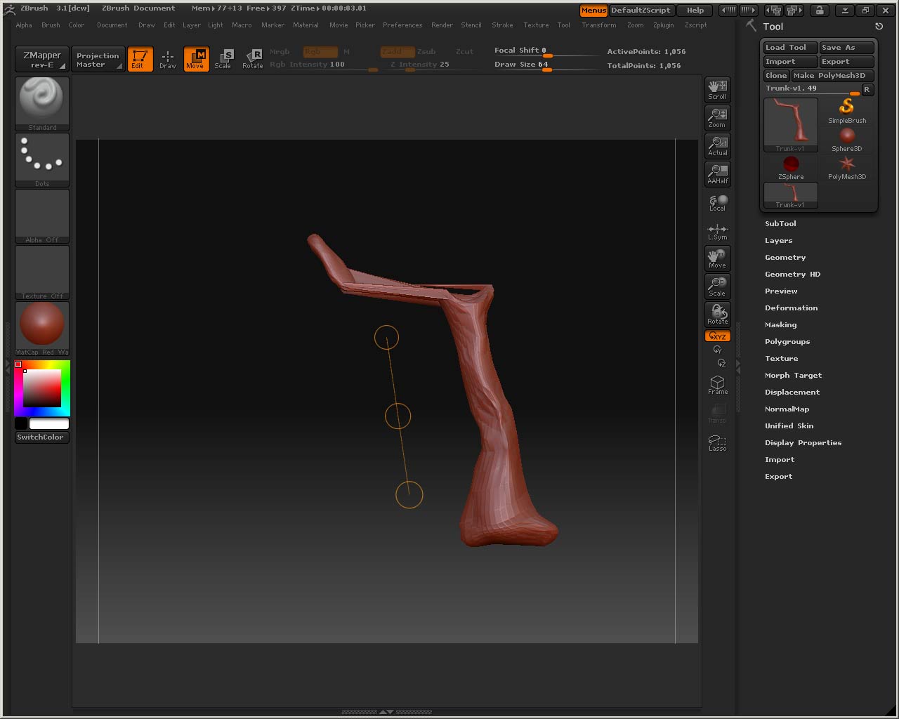

Pictures attached to demonstrate. This particular mesh was created with a ztool primitive then converted to Polymesh3D. No masks, subtools or polygroups in this example.
Changing the transpose action line will change the point at which the mesh is torn apart. Some experimentation and multiple tries at an action line can usually create a normal transpose, but I cannot see a direct correlation between the action line and the defect.
Please see my post above.
