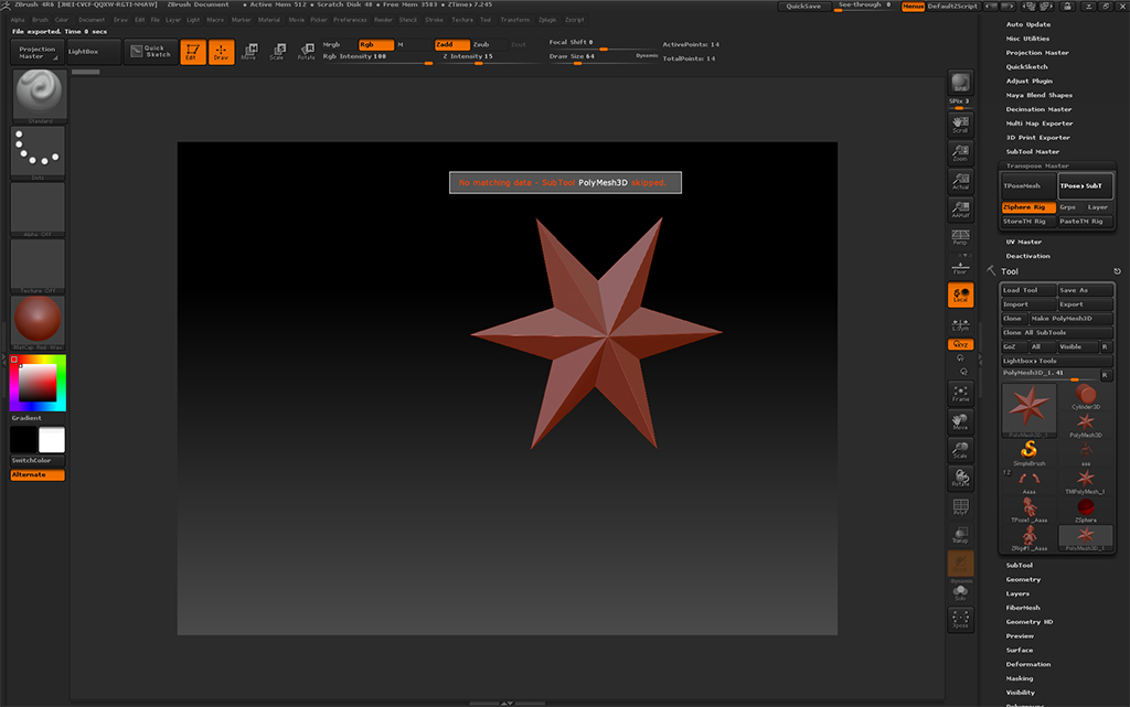

yes i read that document. my problem is shown in the screen shot. it displays that massage when ever i tried to click the tpose subtool button

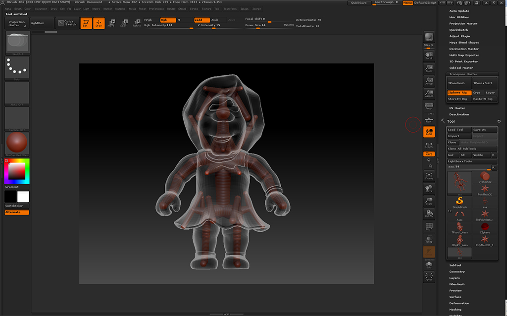

this is my rig.
I think you’re doing it wrong. If you want to pose with your rig, you need to bind it to your model. Read more.
***305;t wad already binded. the problem is i coulndt manage update my unposed model with posed one. I can give a pose by that rig. so it is working. Evereything go wrong when ever i clicked the tpose subt button
it says sory no data match at the end

i think i solved the problem. it is about the version 4r6. 4r5 works fine. I testes both versions the result is like that for now
thank you . yes i read that but unfortunatelly it didnt work even i did everything as mentioned as in that explanation. But the latest version in the name of 4r5 is working properly right now. It is ok for me for now.
