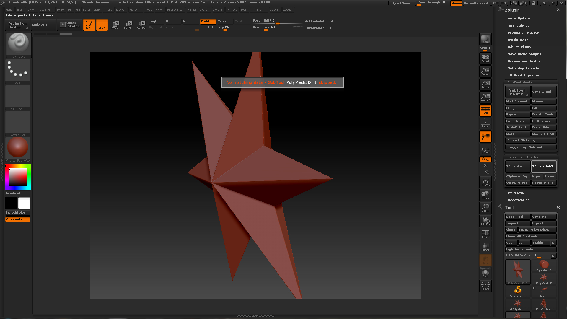

I have a tool with 3 subtools. After I try to T-Pose the mesh, I get the following error when changing from TPose>SubTools and the tool disappears
Is there a reason this could be happening? and how do I resolve the issue?

Yeah, I tried that. Still same thing. What basically happens is that when i hit ‘TPoseMesh’, the tool circled in blue is created. I can then work on the transposed mesh (green). But when I hit ‘TPose>SubT’, I get the tool circled in red. TPose master works perfectly fine with other models though, which is even more confusing
Follow the suggestion at the bottom of this page:
http://docs.pixologic.com/user-guide/zbrush-plugins/transpose-master/
If that doesn’t solve the problem, let me know.
Thank you VERY much! That solved the problem. Is there a way to avoid this happening again in the future, or is it something that randomly crops up?
Well, if you always do that then you shouldn’t encounter it. It’s not random, it happens when the Tool palette contains duplicate parts that you’ve used in your model. Creating a new project gets rid of those. But I plan that the next version of Transpose Master will handle the issue rather better.
